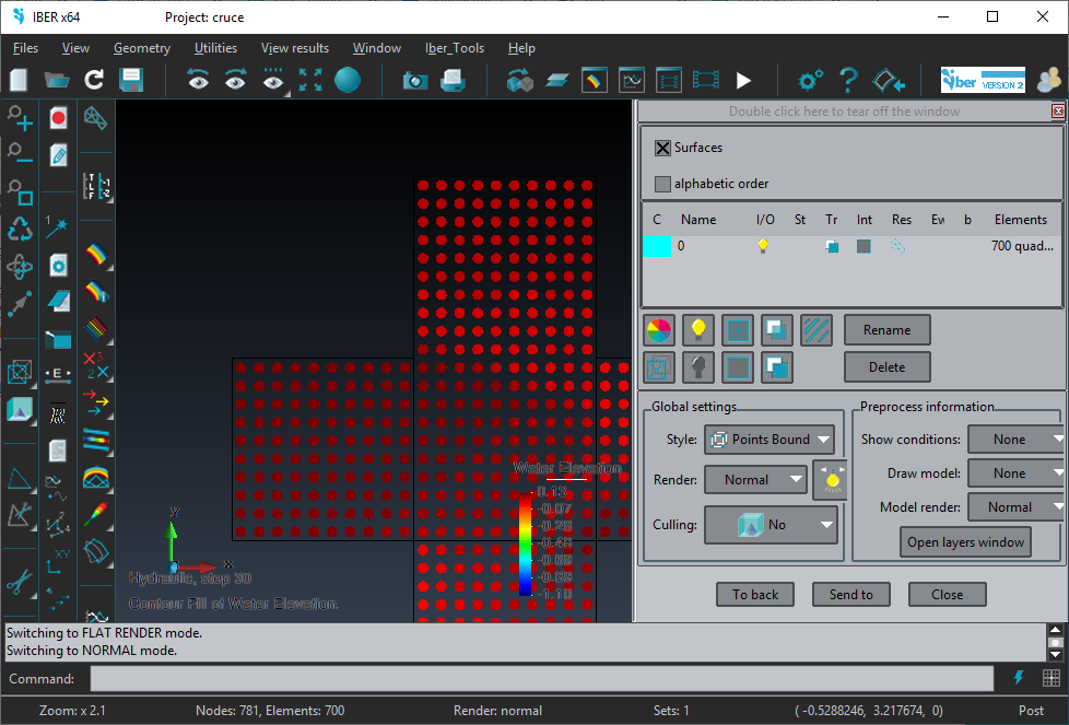

Is it possible to show just a colored point from a scalar result at each gauss point,
instead of drawing contour, extrapolation etc ?
I have a result flag (e.g. cracking) at a concrete element and just want to display that
flag (either by a colored point or a label) on the gauss point itself. It seems easy but I
have not found any way to do it. Thanks !
Re: Show scalars in gauss points
You can set the 'Display style' to Points, or 'Points bound'
then instead to see the elements filled or other kind of visualization the result is represented drawing a point on each gauss point.
You can also have somo control about how this 'point' is drawn in
Utilities->Preferences... Postprocess->Mesh elements
in 'Point element options' could set the 'point size' and quality, and a 'quality factor'. Each point could be represented as a dot, or as a sphere drawn from 'a photo' or as a polygon with more or less detail approximating a sphere.
You can also attach the zip of the model with the result, to test it with the specific type of element, amount and location of gauss point results, etc.
This is an example of a mesh of quadrilaterals with 1 gauss point, with a scalar result represented with 'Display stype'='Points bound'

Thanks a million for the detailed info !

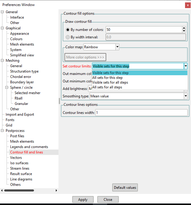

... and generally the legend adjusts the max and min according to all available results instead of the visible results only.
This is extra work because you have to change min and max every time by hand.

My bad, I had to select 'visible sets for this step' in options... now everything is perfect.
about
There is a GiD variable to control this behavior, in Utilities->Preferences...
