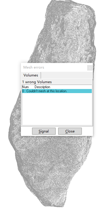

First one is showing that there is a mesh error as shown in the attached picture as "first error" (for mesh 0001r-10000.obj), and if it requires the mesh to be moved to another specific point to be meshed?

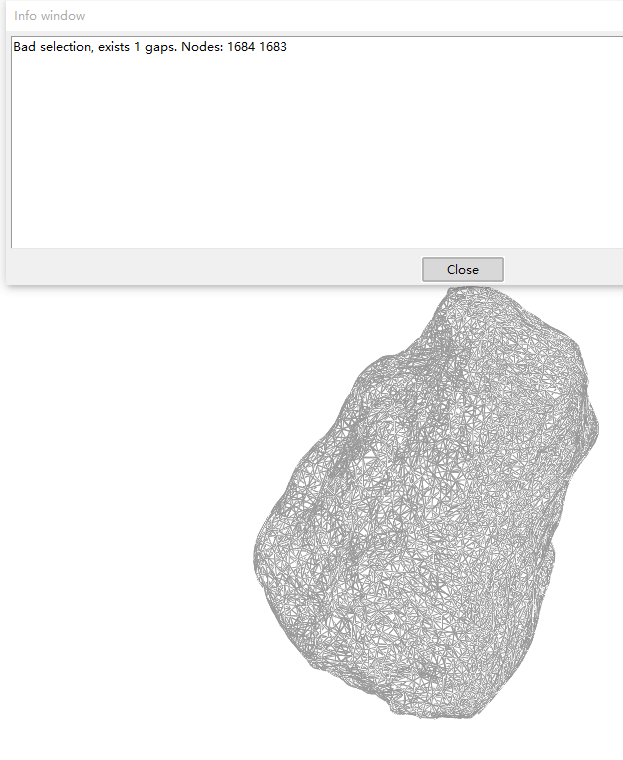

The second one is about "Bad selection, exists 1 gaps..." (as shown in the attached picture as the second error) which I don't quite understand about how to fix this problem?(for mesh 0002r-10000).
