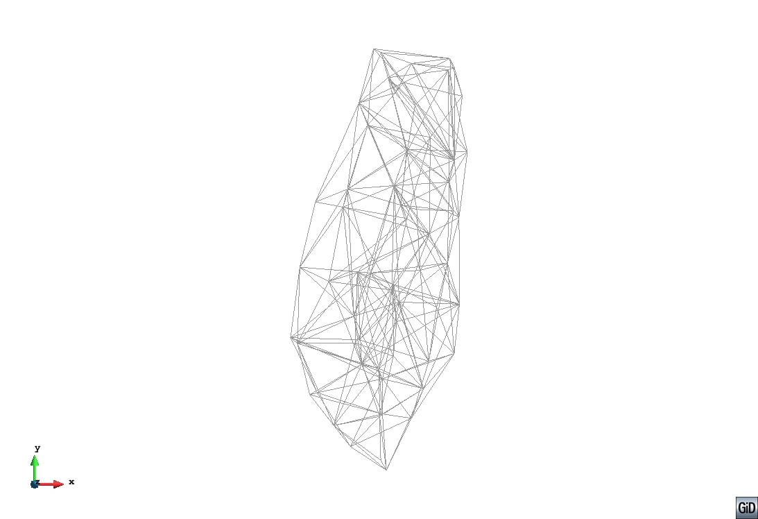

Re: Triangulate Surface Mesh to GiD volumetric Mesh
Hi escolano:
i've tried your suggestions and i am still have some questions about the mesh generated by using the code:Mescape Meshing MeshFromBoundary.
is the mesh generated by applying this code will be a volume mesh?
if not, then should i use the code: Mescape Geometry Create Reconstruct OneSurfForEachElement?
the attached picture is for the one i generated by using the first code. after this the second one cannot be applied to it.
I would really appreciate if you take a look and provide me some help on how to generate it into a volumetric mesh by steps.
Thanks a lot!!
Thanks a lot!!
will generate the volume mesh (tetrahedra) from a closed surface boundary (of triangles).
Depending on other contextual words (click righ-mouse button to show the contextual menu) the original triangles will be deleted or not,
and different volume mesher algorithms and parameters could be selected: advancing front, delaunay (tetgen),...
You can check the kind and amount of elements of your current mesh for example with Utilities->Status...
