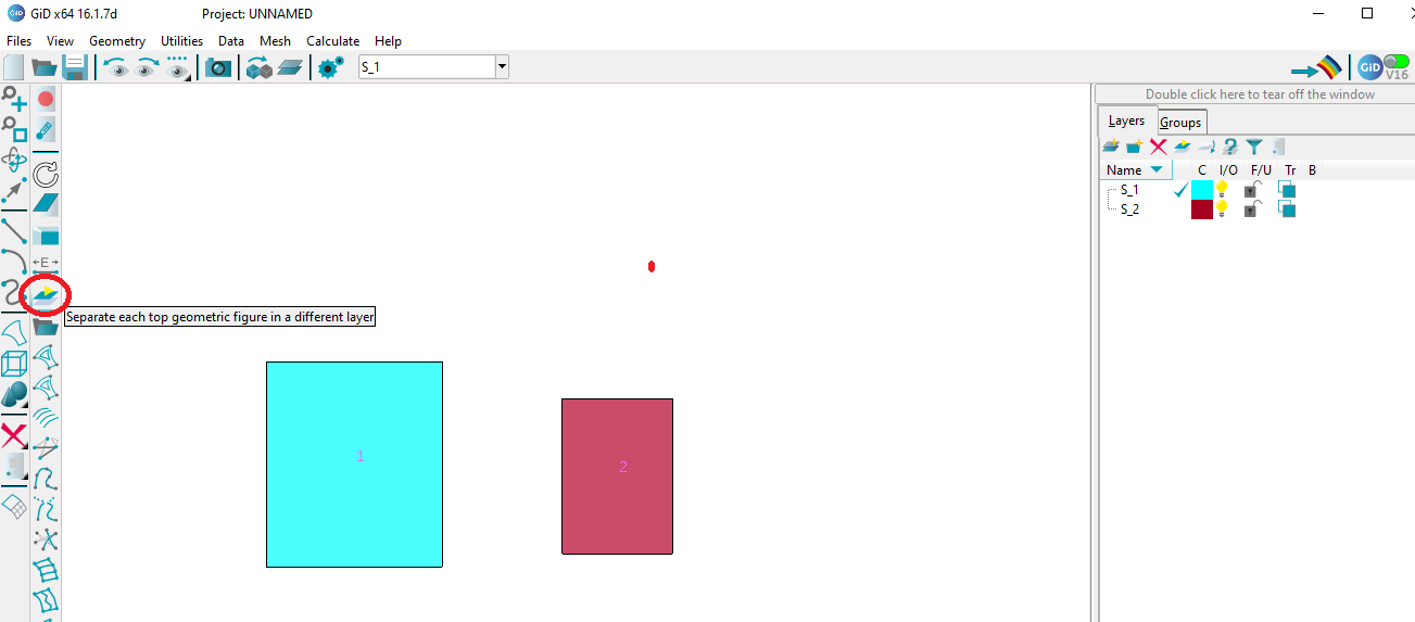

Re: Abaqus import (*.inp file)
As you pointed the tool 'Groups to layers' will create the layers from the selected groups (or all if any is selected)
with the strict entities of the group, won't add to the layer other lower-entities
if do you also want that a layer has its dependencies can select these layers and in the contextual menu select
Send to->Self-dependencies
but take into account that an entity can belong to one, and only one, layer (but can belong to multiple groups)
e.g. a line shared by two surfaces in different layers cannot be in both layers simultaneously
I don't know what is doing the 'tool partition of Abaqus'.
In GiD for example you can use the macro button to send each 'top-level' entity to a new layer
top geometry to layers.png (48.76 KiB) Viewed 20836 times
or can send to a layer some entities and its dependent lower-entities
and while selecting surfaces or curves in the contextual menu the 'Connected tangent' command will add to the selection the entities connected with the current ones that are tangent with a tolerance angle (that could be set to 180 degrees for example to select all connected without take into account its normal)
