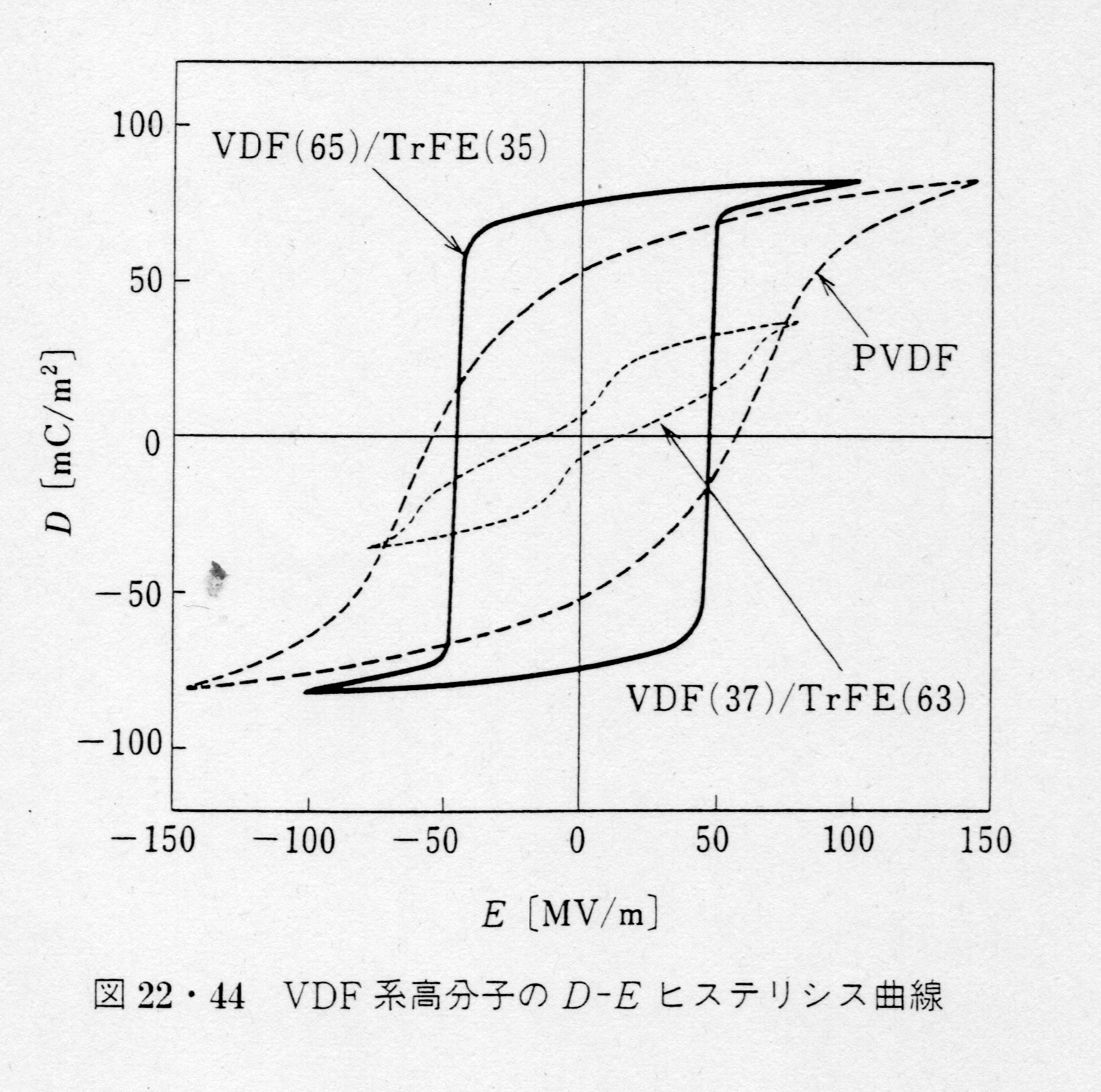

Thank you for all the good information. I will do some tests from now on. For those interested in my function, I attach a diagram from a Japanese book. The thickness of the ferroelectric material shown in the figure is used in very thin thickness, so the strength of the electric field becomes large even when the applied voltage is around 1 volt.
