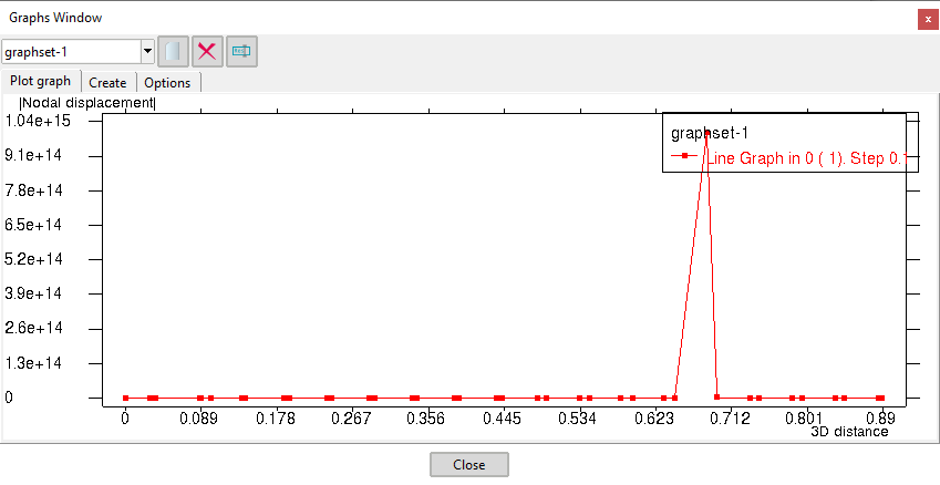

I wanted to change the format of the numbers along the axis on a graph. Unfortunately changing the results format (Preferences - Format) doesn't have any influence of the format of these numbers. Is there any other command or possibility to adjust this format?
Because I don't want to use exponential representation of a number (1,000,000 instead of 1E+06) along an axis.

Unfortunately there is no option to change the number format for graphs.
We will discuss it in order to include it in next versions.

What happened to the idea of introducing EXPONENTIAL for the values on the axes of the graph?
Re: graph - format of the numbers
The graphs show exponential format when needed, but the format is automatic and it cannot be set manually.
See for example the Y-axis numbers
Please, could you attach a zip with your graph and specify how do you exactly want to be shown?
(can export it to a .grf file for example clicking the contextual menu on the graphs window and select Export graph)

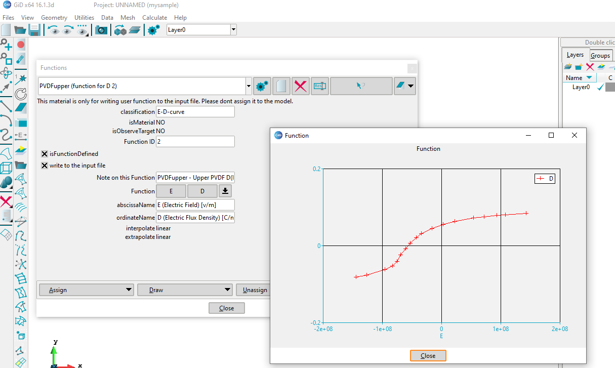

The immediate problem now is trying to define a function in the material data.
I am attaching a file of the problem I encountered. However, it is long and I have modified it by hand to make it shorter.
We are talking of different graph tools
I was talking about the postprocess graph window, implemented in C++ and OpenGL
and by the picture of your attached example you are talking of the auxiliary graph shown in classical problemtype questions, with 'array fields'. This graphs is shown using the TkLib Plotchart scripting package.
I will study your example and provide some solution soon.

I have updated the related graph exponential format (automatic) available in GiD 16.0.4 official and GiD 16.1.3d developer. Both GiD versions are available for download just today:
https://www.gidsimulation.com/gid-for-science/downloads

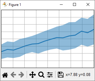

A big new of GiD 16.1.2d developer is that is possible to run Python code from Tcl of GiD and vice-versa
https://gidsimulation.atlassian.net/wik ... hon+in+GiD
This show an example just using matplotlib:
https://gidsimulation.atlassian.net/wik ... ib+example
You can do a fast test writing this in the GiD lower entry
-np- GiD_Python_Exec {<paste_pyton_code_here>}
replacing <paste_pyton_code_here> by some example code of matplotlib like this
https://matplotlib.org/stable/plot_type ... tween.html
import matplotlib.pyplot as plt
import numpy as np
plt.style.use('_mpl-gallery')
# make data
np.random.seed(1)
x = np.linspace(0, 8, 16)
y1 = 3 + 4*x/8 + np.random.uniform(0.0, 0.5, len(x))
y2 = 1 + 2*x/8 + np.random.uniform(0.0, 0.5, len(x))
# plot
fig, ax = plt.subplots()
ax.fill_between(x, y1, y2, alpha=.5, linewidth=0)
ax.plot(x, (y1 + y2)/2, linewidth=2)
ax.set(xlim=(0, 8), xticks=np.arange(1, 8),
       ylim=(0, 8), yticks=np.arange(1, 8))
plt.show()
