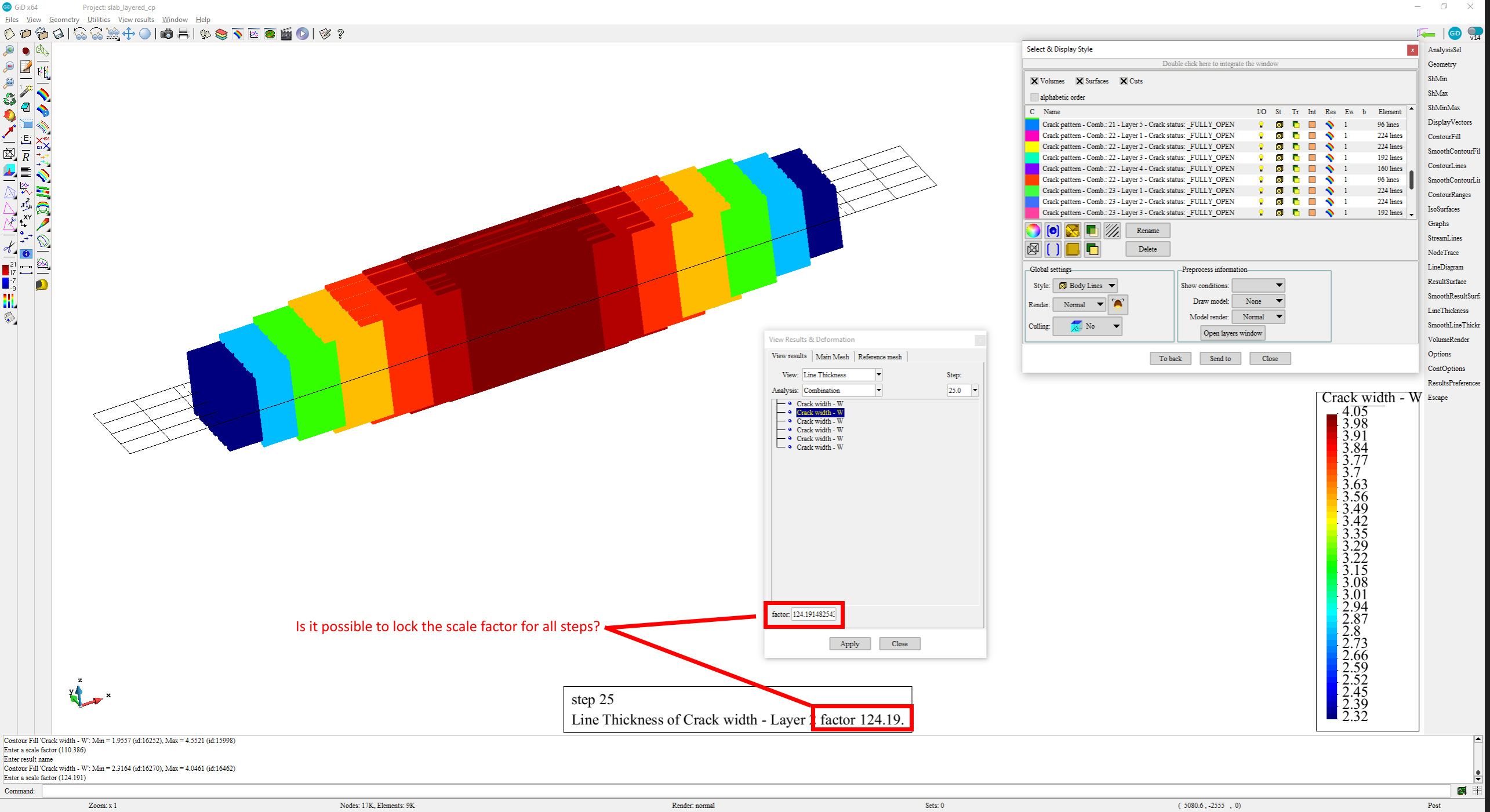

I use the option of "Line thickness" to visualize results in line elements. In order to check the evolution of the results for different steps, I use the animation tool. I want to know if it is possible to lock the scale factor for the line thickness results because if I previously change the scale factor for a given step, the scale factor is automatically changed when the step changes.

the problem has been corrected for the next versions of gid. when changing the time-step or doing an animation, the sacle factor of both visualization types: line thickness and result surface will be preserved.
thanks for the report!
