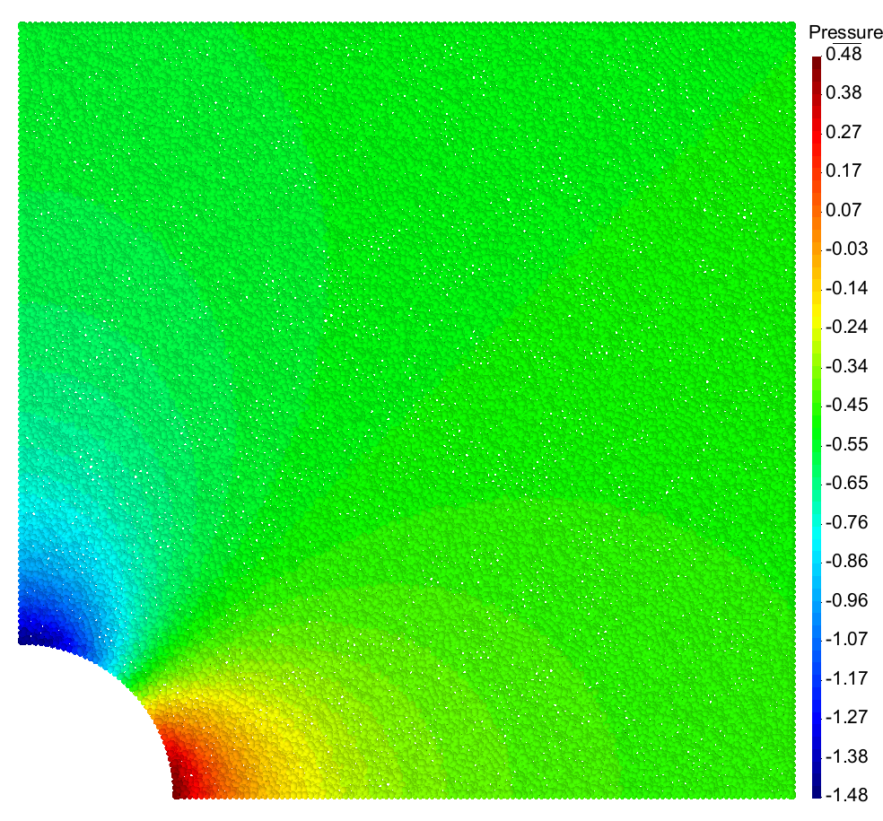

Hello, I've noticed that with newer GiD versions the legend has been getting thinner. In version 13 the legends were by default way thicker. In Version 15 it is just too thin as shown in the attached file. Is there any way to increase its width?

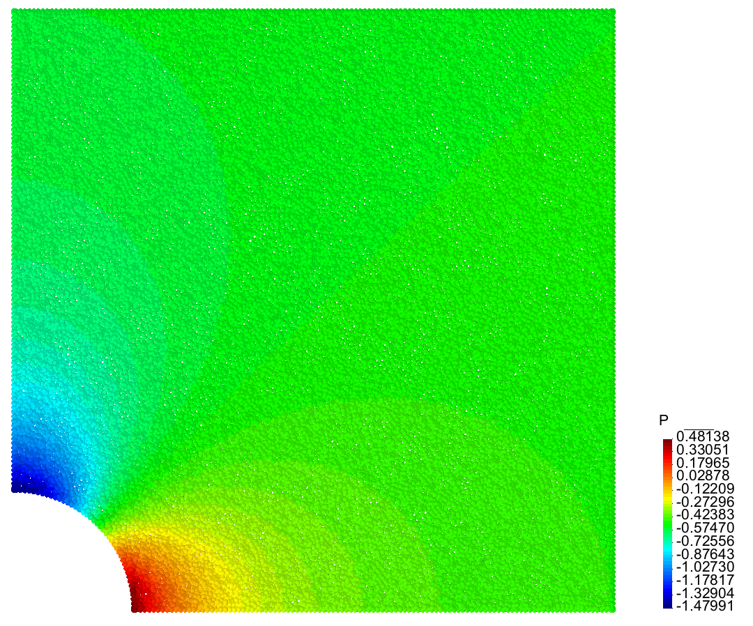

Thanks Enrique. I meant the default view of the legend looked thicker in older GiD versions.
I had already tried the options that is offered through the GUI and that didn't work. Still the legend looks too thin under my perspective. See new picture. I am more inclined to change the width via the GiD command line. For instance, to remove the axis I do the following:
Mescape View Hardcopy Options _showaxes No
Is there any command that allows changing the width of the legend?

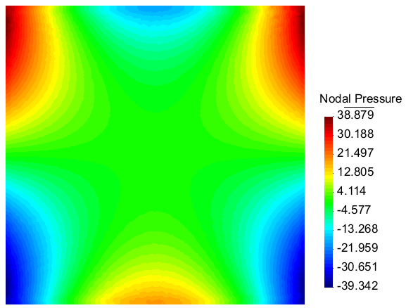

This was obtained using GiD 10 (got it from a paper of myself of 2011 since I can't find the original files):
But besides this, my question is: is it possible to access additional legend customization through the GiD command line that is not available in the GUI?

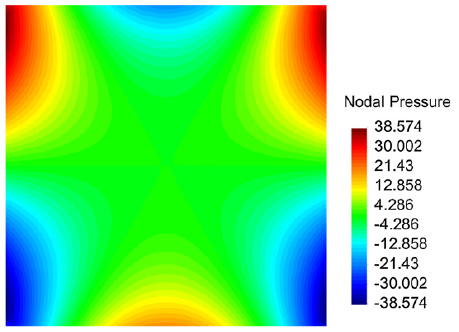

I can't find the original files, but I attach one zipped I replicated in GiD 15. This is the outcome:
In the second picture the color bar looks thinner and there is more space between any pair of numbers. I would like to approach the look of the first image above.But besides this, my question is: is it possible to access additional legend customization through the GiD command line that is not available in the GUI?
