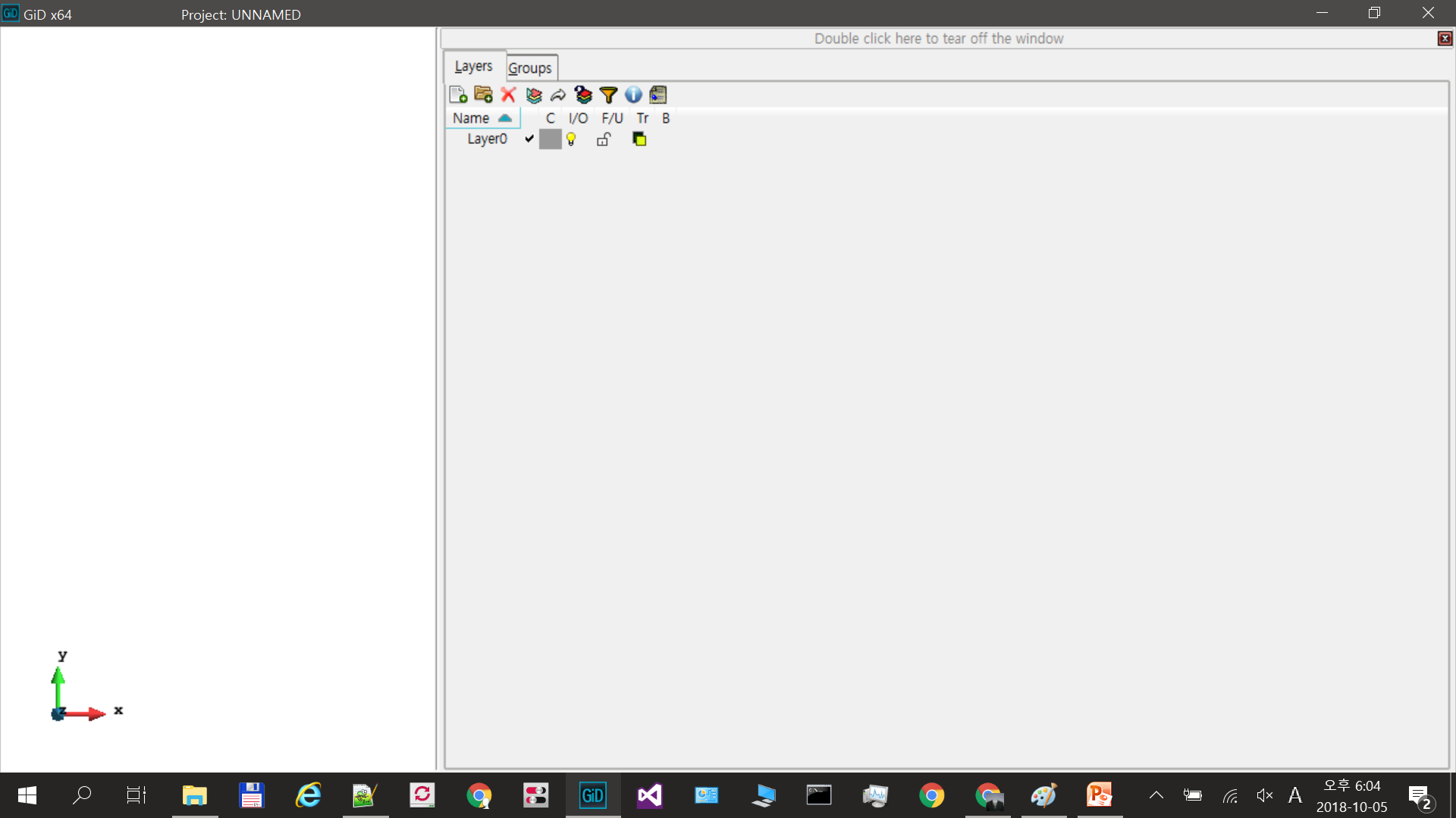

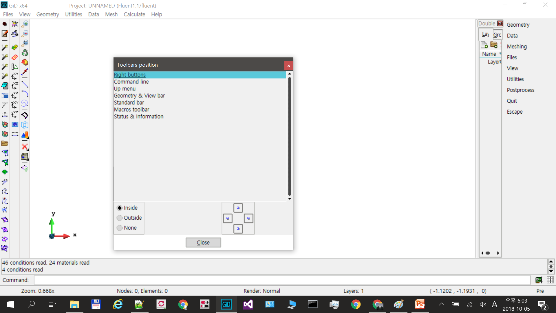

Due to my mistake Gid Default menu is disappear.
And, when open problemtype, occured error about toolbar.
I can't do Anything gid.
please help...

If GiD is starting without menus, delete the user preferences file, to restore the initial defaults:
see this FAQ: https://www.gidhome.com/documents/faqgi ... references
And if you are modifying some problem type and it raise errors when loading, off course must fix these errors.

Thanks a lot!!!
Restoring .ini data file solved all errors and problem.
