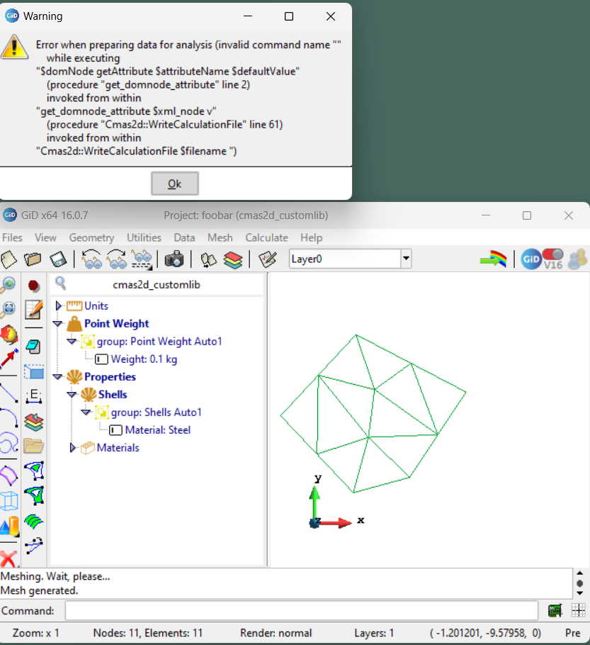

An error was generated when I changed the writing.tcl in the cmas2d_customelib problem type by inserting the sample lines of code given in the manual.
The following code is given in the customisation manual (page 42; in the "Accessing tree data information" section).
I inserted it into the writing.tcl code of the cmas2d_customlib problem type, just before the "customlib::EndWriteFile" line.
    (writing.tcl code; many lines omitted!)

set document [$::gid_groups_conds::doc documentElement]
set xpath {/cmas2d_customlib_data/condition[@n='Point_Weight']/group[@name='Point Weight Auto1']/value[@n='Weight']}
set xml_node [$document selectNodes $xpath]
set value [get_domnode_attribute $xml_node v]
    customlib::EndWriteFile ;#finish writting
As shown in the figure, I encountered an error after CntlX-CntlC operation.
What is wrong with me?
Am using GiD 16.0.7 on Windows11 Pro.

It is a mistake of the documentation,
in this case the attribute of the node 'group' must be 'n', not 'name'
group[@n='Point Weight Auto1']
Now we have fixed this documentation:
https://gidsimulation.atlassian.net/wik ... nformation
Then $document selectNodes $xpath was not selecting any DOM node because the wrong xpath
In any case, you can always examine the current DOM to know the xpath with something like
-np- W [[$::gid_groups_conds::doc documentElement] asXML]
and you will see it as XML, this in your model:
