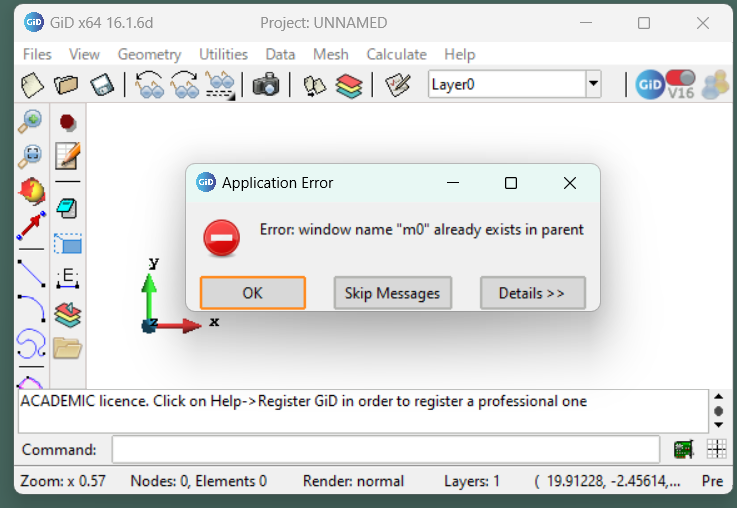

I am using GiD16.1.6d on Windows11Pro.
I wanted to place some problemtypes at the directory, that is,
C:\Users\<your_windows_user>\AppData\Roaming\GiD\16.1.6d\problemtypes
If unzip testOK.zip, and start GiD16.1.6.d. GiD can handle problem types properly.
Please remove all files just unzipped.
And then, if unzip testERROR.zip, in which my problemtypes are placed under the subdirectory SomeCompany/, and start GiD16.1.6.d. There arises an error:
Error: window name "m0" already exists in parent.
Another related issue:
If some directory is "permission denied", immediate fault occurs.
problemtypes are placed under the subdirectory, in Roaming\GiD\16.1.6d\problemtypes\SomeCompany\
- testERROR.zip
- (6.59 KiB) Downloaded 833 times
- testOK.zip
- (6.31 KiB) Downloaded 756 times

The error I reported has not been corrected for both GiD16.07 and GiD16.1.8d.
'Application Error'
'Error window name "m0" already exists in parent'
Please check again.
