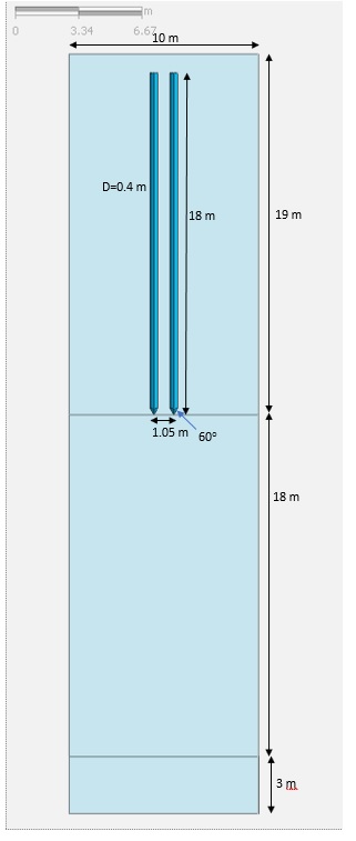

I wish to model penetration of 2 inclusions in soil. The sub soil is divided into 2 layers (18m and 3m). Above the ground surface are 2 inclusions. The diameter of inclusion is 0.4 m, length is 18m, tip is 60 degree cone shape, 1.05m apart. The tip of the cone is coincide with the group surface. Top of the domain is 1 m above top of inclusion, ie 19m - 18m. I wish to know how to model this in GiD ? I am worry about the coincidence or intersection of the tip of the cone to the ground surface. How to model this ? Please help.

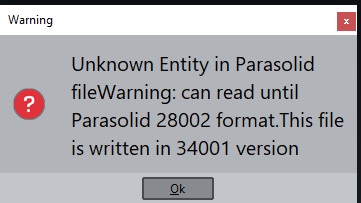

I have created the 3d geometry in Midas GTS nx. I exported to parasolid but GiD said older version is required. Any chance of importing the newer version of parasolid file ?

Please, attach the Parasolid file with the model,
and also find inside the Midas GTS nx folders if there is a file named like
sch_34001.sch_txt
(or something similar *_34001* )
This file is the schema the describes the data in the Parasolid format of this version,
to try to identify the changes vs previous versions and be able to be read in next GiDs
In any case the geometry of your picture seems simple to be created directly in GiD, a couple of lines revolved to create the inclusion, and a box holed with this volume.
sch_34001.sch_txt

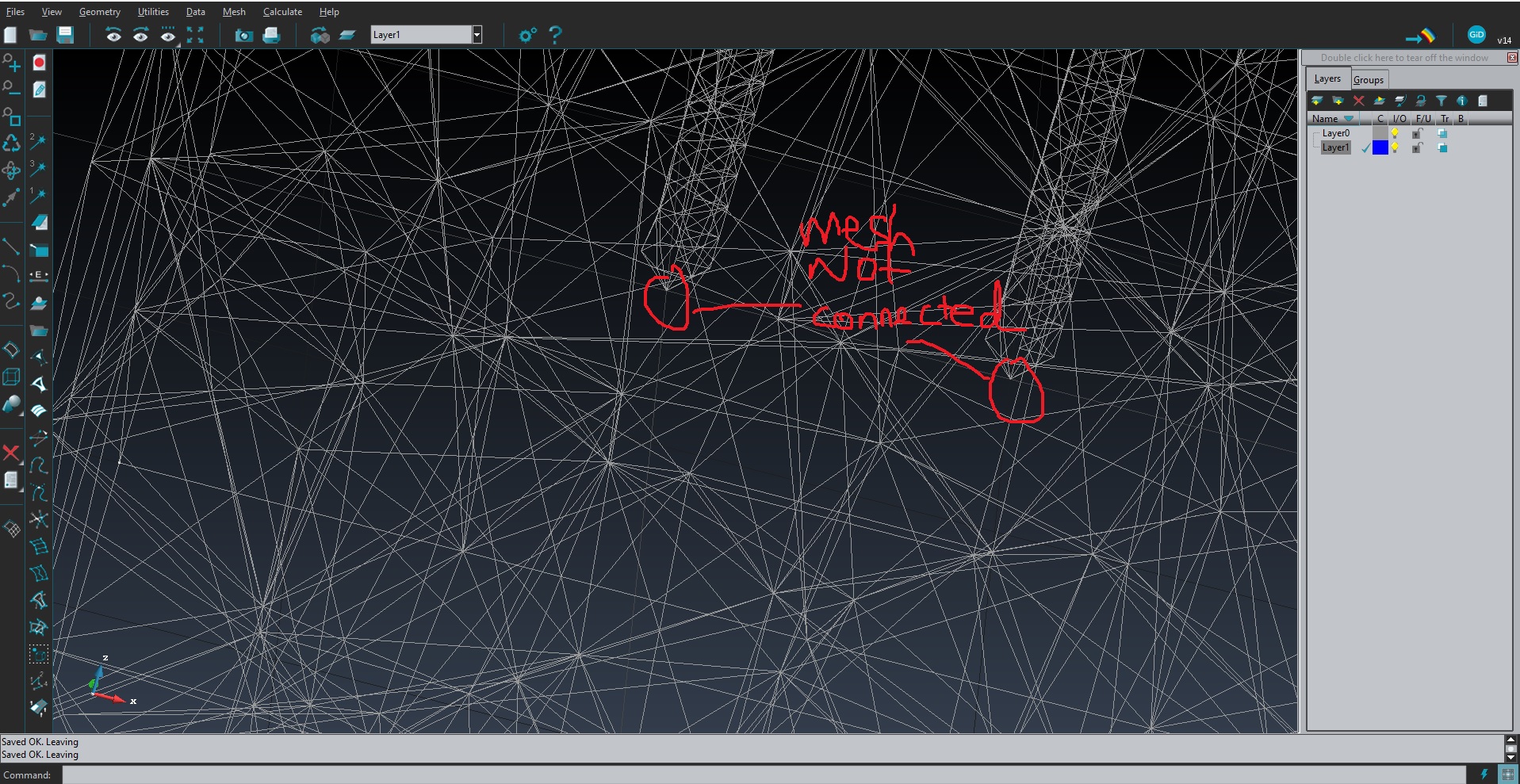

I keyed in points of a cone in 3D. Then i drew surface of the cone. Then, i create volume using copy>rotate function. Then, I copied the volume of cone to put it 1 meter on the right of the first cone. Then, I keyed in points of four corners of a plane where the z of the plane is coincident with the tip of the cone. I then create surface of the plane and z=0. Then, I extrude up 6 m to create box volume. Then, i do the same for z=-6 m to simulate soil.
But when i mesh the two cones and the box, the mesh of the cone do not connected with the box. Is there any function to connect the tip to the box, like auto-connect in Midas GTS ?

Re: How to create 3d geometry for penetration problem ?
Your model has 2 volumes and in the middle a volume the surfaces of piles.
delete the surface of the piles that seems that you used for the revolution, to have only the boundary surfaces.
then can create a volume for each pile
and then can hole the volume of the soil (Geomtry->Edit->Hole volume) with the two previous pile volumes
then these volumes are deleted and are created as holes of the first volume.
then to generate the volume mesh theres is a problem because the apex of the pile is touching the boundary of the volume, and a hole must be inside the volume, not touching the boundary (otherwise won't be space in the middle to be filled with tetrahedra).
to overcome this problem I simply joined the two soil volumes in a single volume (Geometry->Edit->Join->Volumes)
Then is possible to generate the mesh of the soil you want, of a solid holed with the shape of two piles.
I attach my model
I attach my model
Please, send me the file "2 pile group.X_B"
It is the Parasolid binary format v 34001 of your example
To try to implementing the parasolid version changes in future GiD importer.
If do you really need two soil volumes instead one (e.g. to assign different material properties), and the division surface is exactly on the apex point, then is necessary to create the divisory surfaces with this point in its boundary, like this image:
I attach this second GiD model
