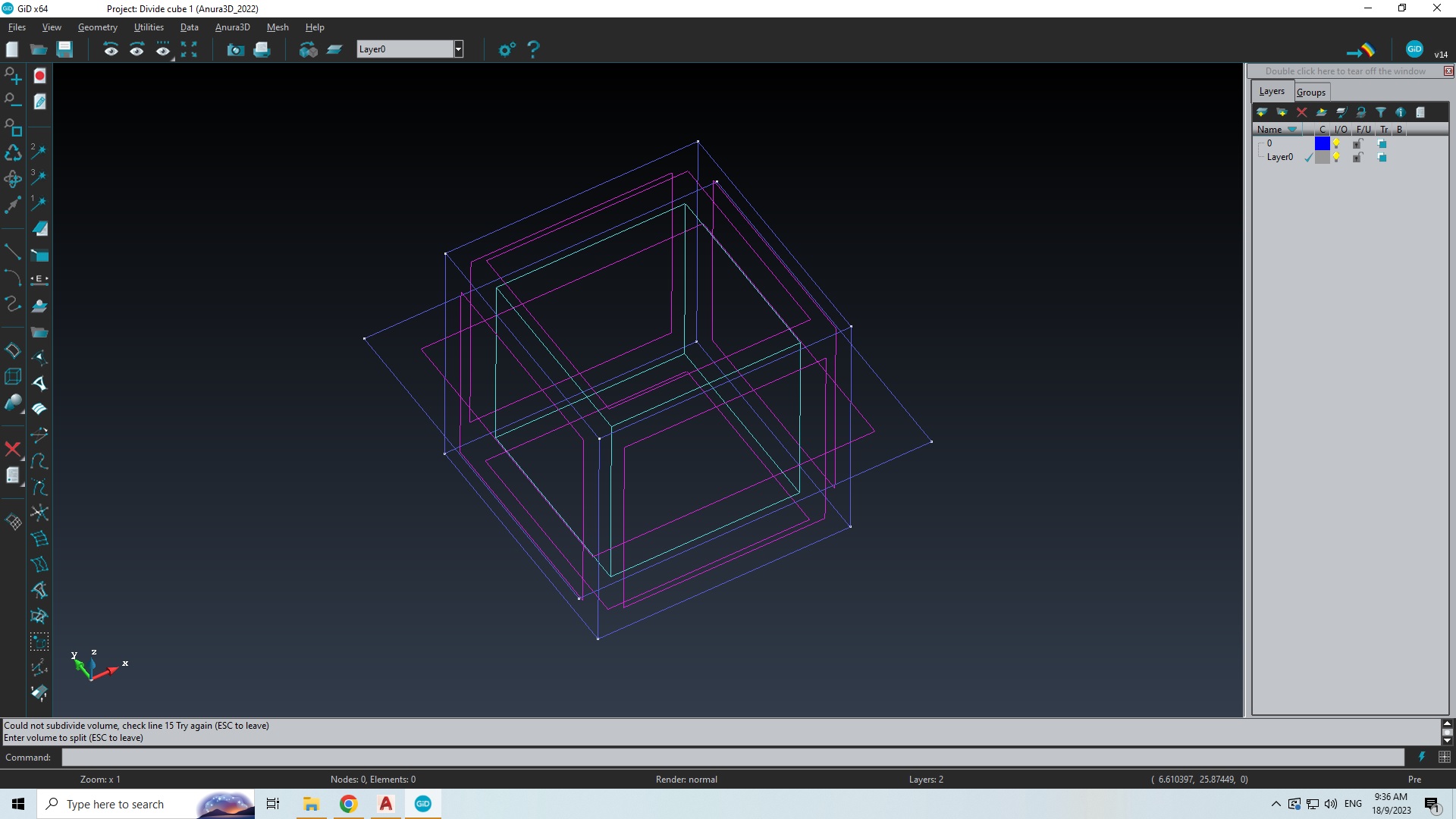

I want to divide a 3d cube by a 2d surface. The cube is 10mx10mx10m. The diving plane is 5 m above Z=0. I divided the volume via geometry>edit>divide>volume>split
But GiD said "Could not subdivide volume, check line 15 Try again".

Re: How to divide a volume
The volume split tool do not find and create intersections curve-curve, curve-surface, and surface-surface,
all curves and surfaces must be subdivided before to used, then you must select a collection of surfaces that separate the volume in two or more regions.
1- To identify an entity knowing its id can use
Utilities->Signal->Lines
15
or View->Label->Selected ON->Lines
15

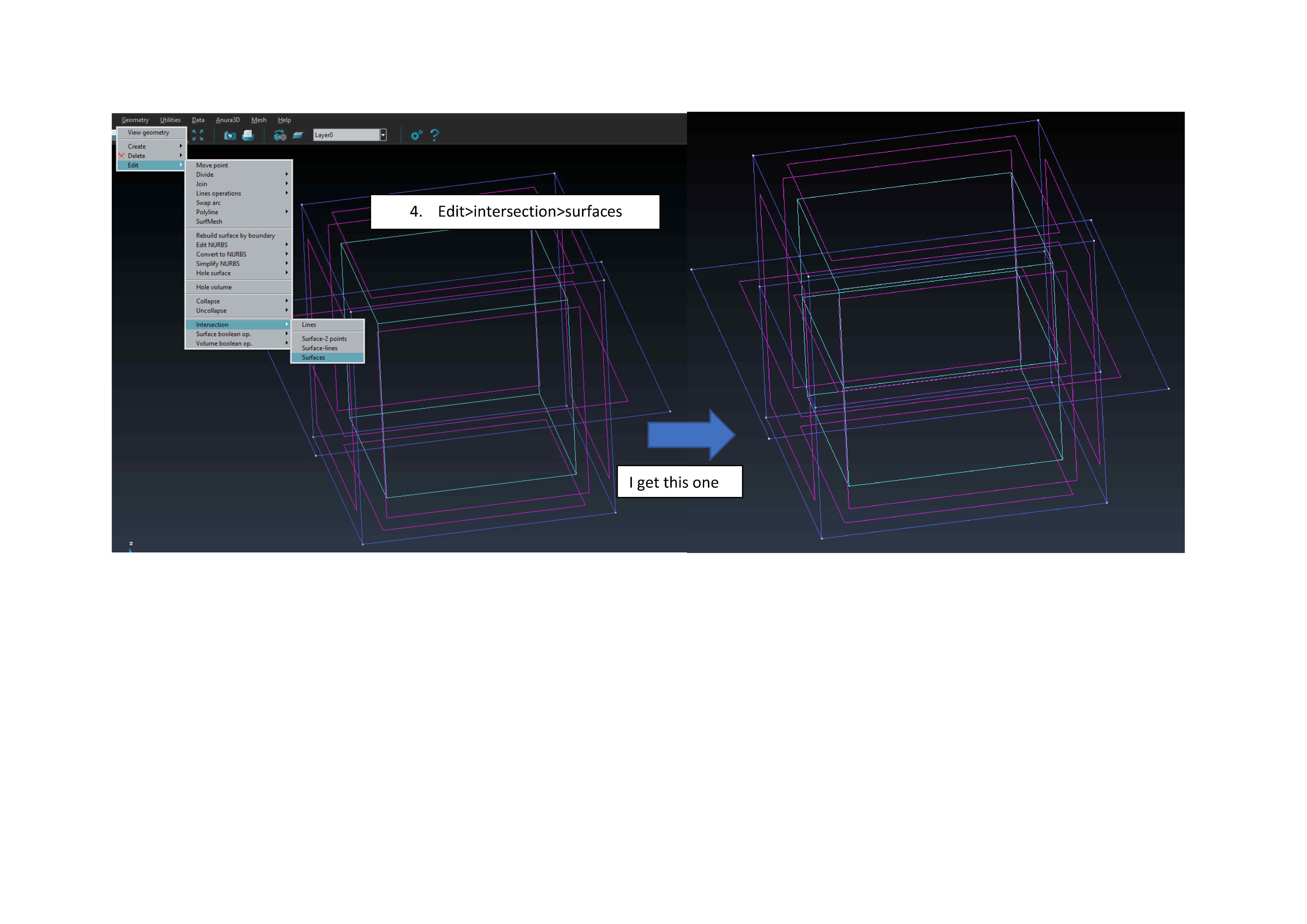

2- First must divide lines and surfaces and this require create intersections
e.g.
Geometry->Edit->Intersection->Surfaces
and select the surfaces you want, in this case can select all then can split the volume in two selecting the first the volume and then the surface in blue
3- You will see in 'render normal' that there are two volumes, represented by the scaled cyan curves of its boundary. You can also list the entities to know what do you exactly have.

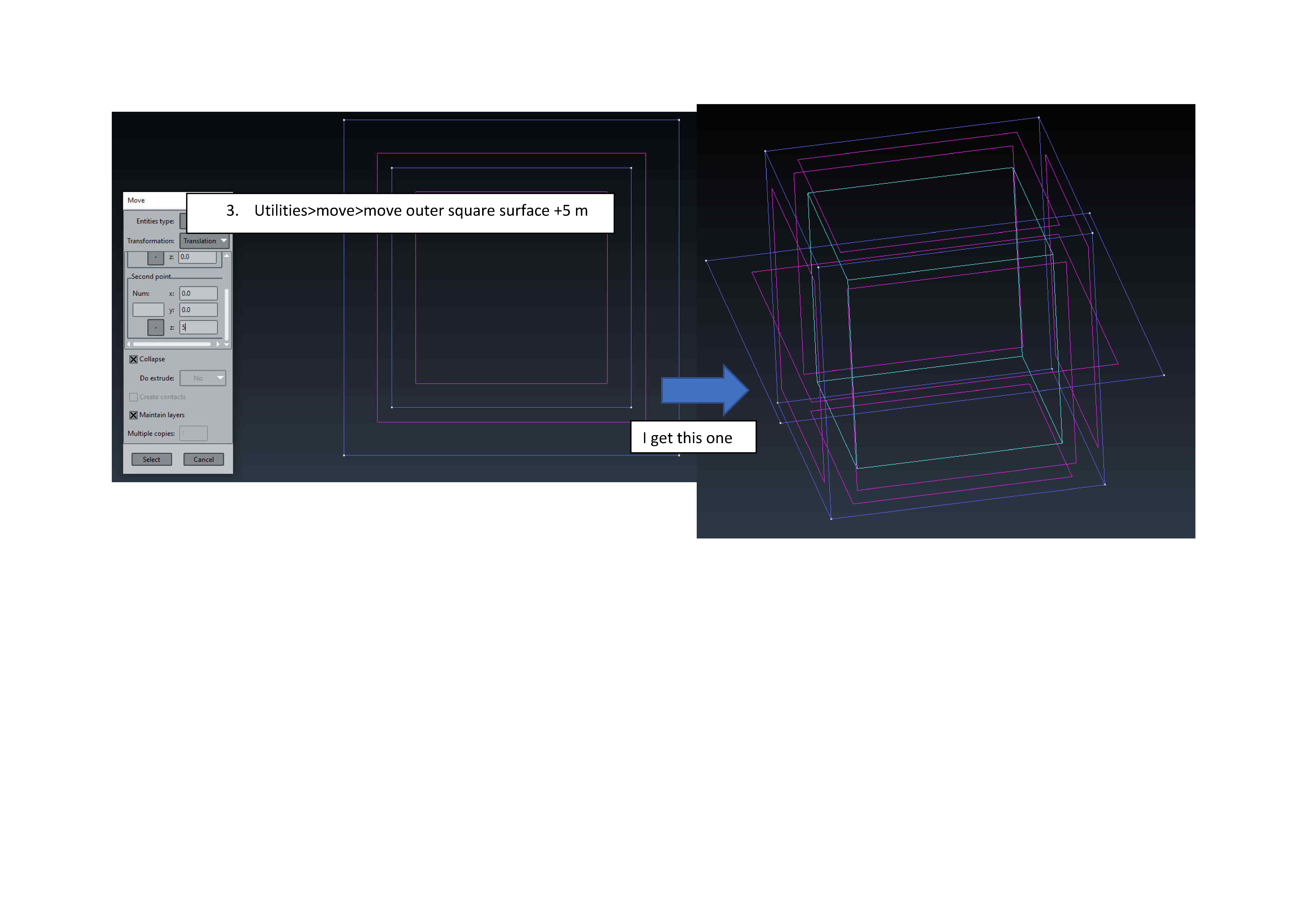

Dear escolano,
After dividing all the surfaces, how to divide the volume ? How to show the volume is divided into 2 ? Can you tell me how to set the geometry such as yours ? How to create volume that embeded into a box ? Do I need to carry out volume boolean operation ?
Thank you.

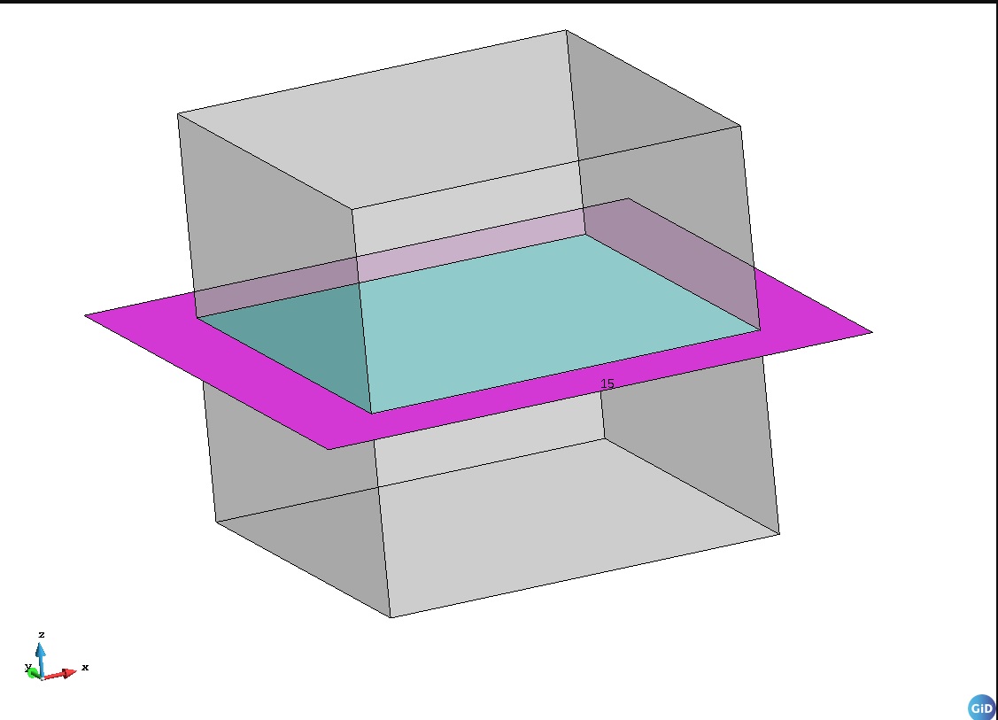

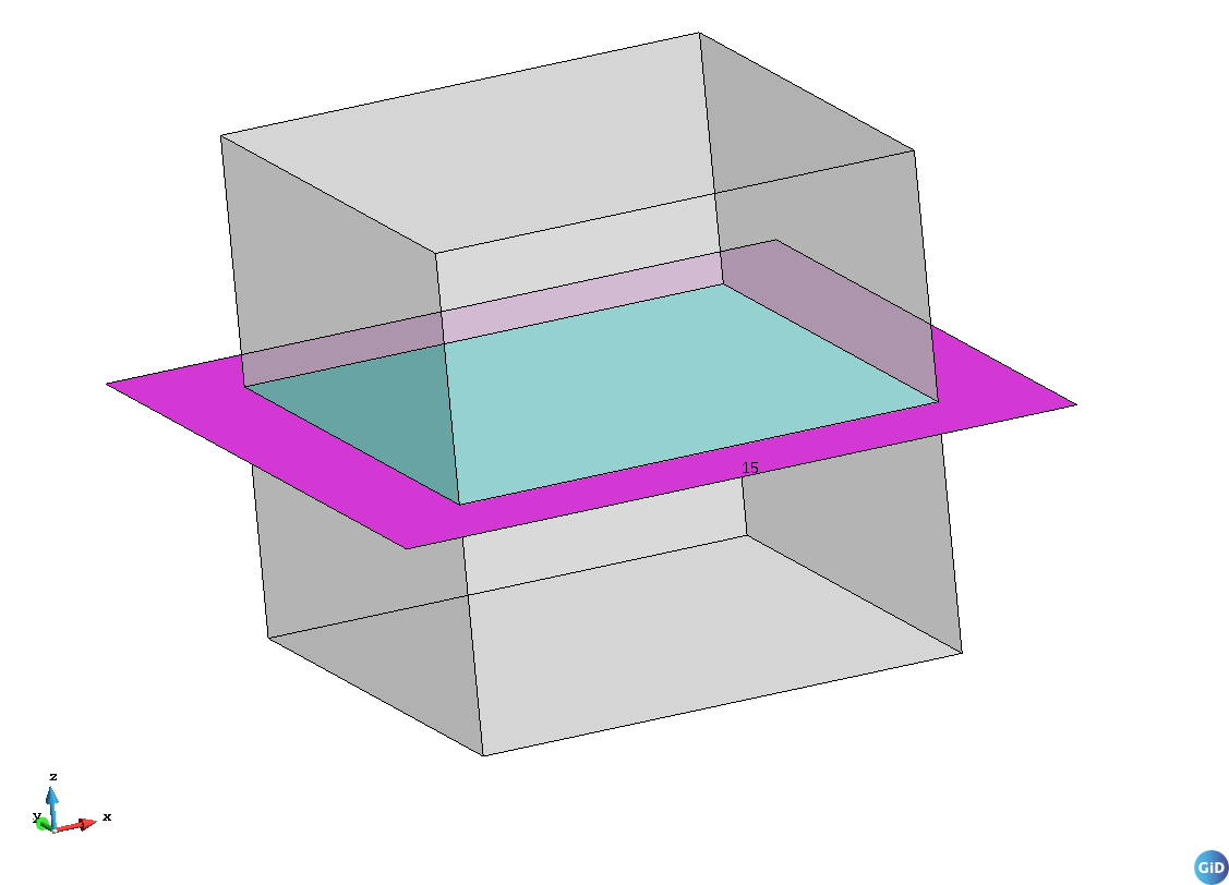

In my example, after intersect the surfaces I have send a surface to other layer, only to visually show you that the intersection of surfaces has also splitted this surface in two new surfaces pink and cyan (and I have set the layer of the volume transparent to see the inner surfaces)
You can just delete the pink surface (and its dependencies) that is unneeded,
and to divide the volume simply
Geometry->Edit->Divide->Volumes->Split
select the volume
and select the cyan surface (in render normal can be selected more easy, or you can set on/off layers to aid the selection, or enter the id if you know its number)
You can visually see that now there are two volumes, e.g. one is selected in red to identify what do you have in your model
you can send entities to different layers, list them, set on its labels, change render normal/flat, etc.
