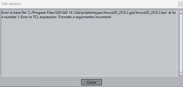

Hello everyone! i'm currently running a model with GiD and Anura3d using the material point method, but after some time working perfectly, this message appears just when i start to generate the files to run my model. im not used to code or anything to do with super computational skills, so if anyone has an idea with this, please, id love to read it. Thanks!
in case that the image isn't uploaded. it says:
Error in base file 'C:/Program Files/GiD/GiD 14.1.0d/problemtypes/Anura3D_2019.2.gid/Anura3D_2019.2.bas' at line number 1: Error in TCL expression: 'Formato o argumentos incorrecto'

I don't have a copy of this problemtype
Anura3D_2019.2.gid
I have other versions like Anura3D_2017.2.gid and Anura3D_2022.gid
and the line 1 of the file .bas in my copies is
*tcl(Anura3D::CreateBatch *FileId)
and this Tcl proc is defined in the .tcl file, it seems that in your case GiD 14.1.0d is raising some error evaluating this function.
Maybe your copy of the problemtype is corrupted?
attach a zip with your problemtype, and another zip with the gid model that is raising the error

Re: HELP
I have installed your same GiD version (14.1.0d Windows x64)
copied your attached problemtype (adding a folder images from other anura version, to avoid error reading missing images)
and opened your model and I can export the anura calculation data
e.g.
with Files->Export->Calculation files (.dat files are written ok)
or menu Anura3D->Generate Anura 3D files
Try again resetting your gid.ini file: https://gidsimulation.atlassian.net/wik ... references
If continue failing with the same error, try to debug with ramdebugger the Tcl scripting proc Anura3D::CreateBatch step by step:
1-Data->Problemtype->Debugger...
and open the Tcl problemtype file <GiD>\problemtypes\Anura3D_2019.2.gid\Anura3D_2019.2.tcl
2-set a breakpoint with the key <F9> in the first line of the proc
proc Anura3D::CreateBatch { channel } {
set project_path [GiD_Info Project ModelName]
3-start debugging with <F5>
4- export in anura the calculation file, and then the debugger will be stopped in the breakpoint line, then can see variables and go step by step with <F10> to try to identify the error
e.g.
