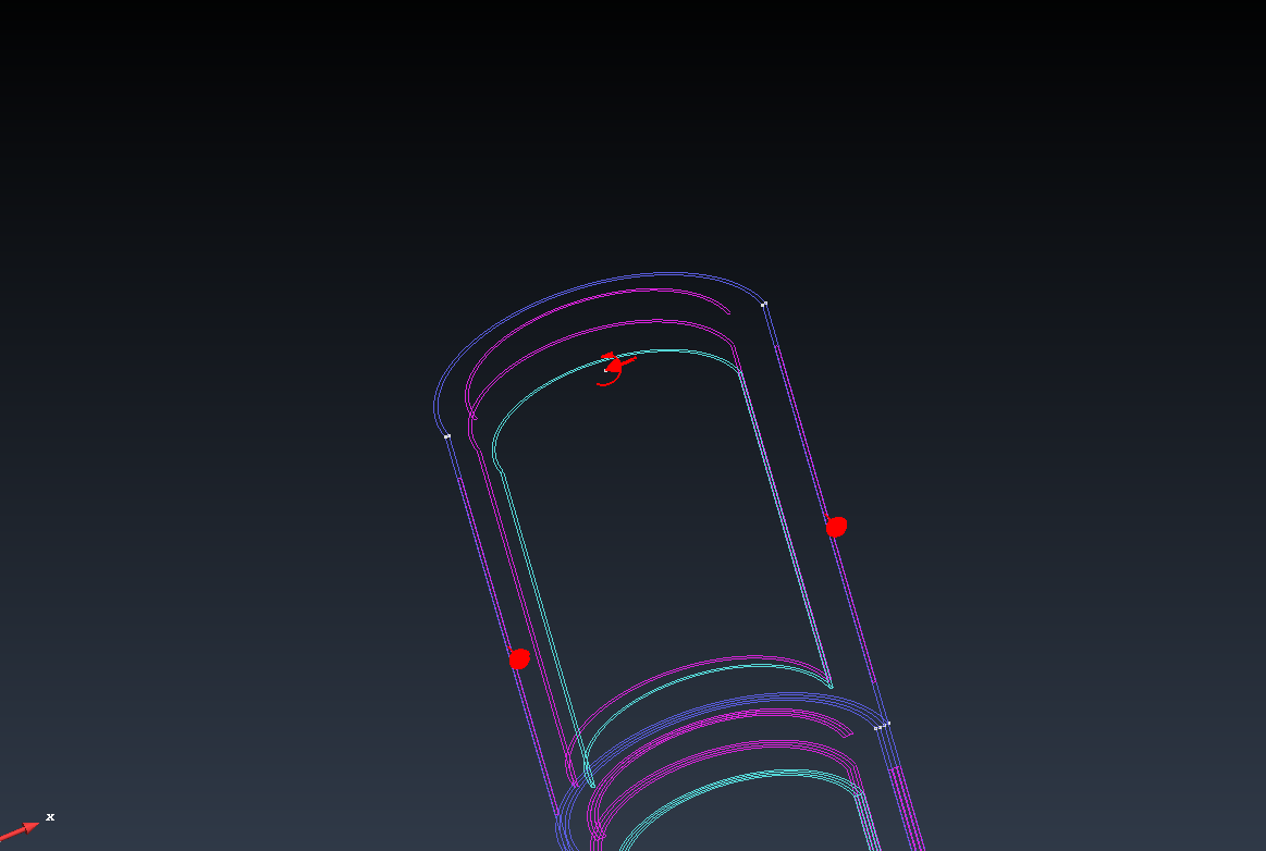

Hello everyone,
How could I connect a point, in which I have attached an horizontal load and a moment, to the upper surface of a hollow, semicircular monopile volume? In other words, how could I define a beam type, multipoint constraint (MPC) using as control point the point I have loaded and as slave nodes the nodes of the surface?
Thank you in advance

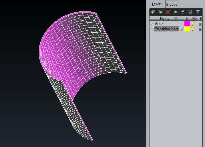

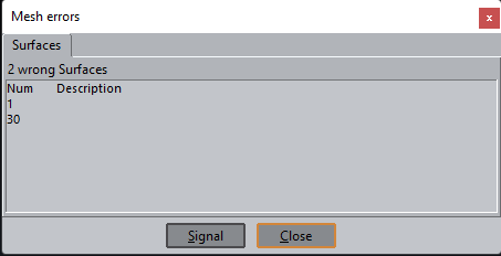

Thank you for the prompt response.
I do that but then I get an error message.
And while viewing the mesh, I can only see the mesh of the volume whose I use the surface. The other volume dissapears.

Re: Connect a point to a surface
Force a node to the mesh is only valid for unstructured meshes and your picture show a structured mesh
A structured mesh is more restrictive nd the nodes cannot be set in an arbitrary 3D location
The mesh of the volume with the forced point is not seen because the mesh generation has failed.
To do a structured mesh cannot use 'force points to mesh', and must divide your geometry in several volumes to have a point as corner of a volume.
It is also possible to assign the condition directly to the mesh, to the node you want close to the point, but in general is not a good approach because if do you generate a new mesh you will lost the directly assigned condition.
