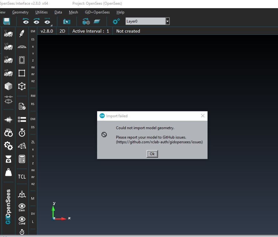

I am a new user of GID interface and I was trying to import an example.tcl file from opensees wiki website below.
https://opensees.berkeley.edu/wiki/inde ... ifuge_Test
I can import different files, but this example's file doesn't work. Does anyone have the same problem?
Thanks
Cannot import an example tcl file...

Hello Escolano,
Thank you for your detailed explanation.
I got the example file from the site below.
https://opensees.berkeley.edu/OpenSees/ ... l/4188.htm
I've been studying on GID+OpenSees Interface v2.8.0 and I see that it allows to import .tcl file.
Actually the problem is I cannot import that specific tcl file I attached earlier. I did import many others. And I managed to see the geometry and run the analysis...But when I try it for the attached file, it freezes, when I try to exit it gives me "Import failed" error.
So you're saying that I need a .gid file but I did manage to import tcl files for different examples that has not . gid files in the folder.
Thank you again for your reply.

Re: Cannot import an example tcl file...
By the header of the file
# This file is created from GID pre- and post-processor #
# using "geoOpenSees.gid" Problem Type #
it seems that it was not created by the "GiD+OpenSees" interface, but by another problemtype called "geoOpenSees.gid" (maybe can contact the tutorial author to have a copy of this problemtype and of the original GiD model also)
I have tried to import the file with "GiD+OpenSees" v 2.8.0 Windows x64, that seems that implements an importer but it start an auxiliary exe TclToGiD.exe that is not able to read this case (in my test become frozen).
Do an importer of only the mesh nodes and elements seem easy with a few of scripting,
but do an importer of the full syntax of an OpenSees file seems very difficult, because this file is really a Tcl scripting and its content could be very complex and heterogeneous. I think also that "GiD+OpenSees" is more devoted to structural cases that geothechical ones, and is not covering all simulation possibilites of OpenSees. Maybe the importer is able to import the kind of 'opensees .tcl' files that are written by himself.
You can create the GiD geometry from scratch, it seems a very simple geometry, but I am not sure is the "GiD+OpenSees" problemtype will be able to represent all data (boundary conditions, general data, simulation strategy...) to do this kind of simulation and write a calculation file for OpenSees equivalent of the one of the example. (but I am not user of "GiD+OpenSees" and really I don't know its features)
I understand now.
Thank you for your time and the information.
I think I will contact the coder...
Thanks again.
