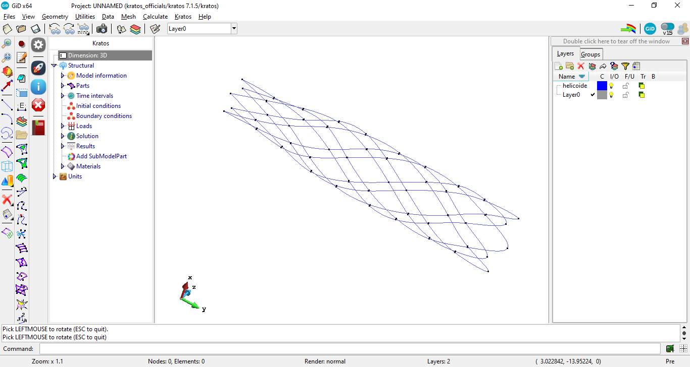

Really creating this kind of geometry could be near-imposible with GiD
You must try to create with an external CAD and import it.
I don't know the kind of model you want to obtain: e.g. volumes, or curves
A similar case, to create medical stents, has been solved writing specialiced Tcl/Tk scripts that create a model of curves from some parameters.
The images are of the kratos 7.1.5 stent application

This article is of 2013 year.
It seems that Ruben Otí­n has wrote a specialized Tcl/Tk scripting to generate the GiD geometries,
similar to the images that I have shown to create stents
I will try to contact him (he's not working at CIMNE nowadays), and ask if already has a copy of the scripts or models
