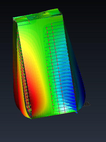

Hi, lately i w was modelling a n highrise building in GiD, and i'm facing an issue here. show the image. I modelled the facade as a shell elements. in the post process model it doesn't connect with other nodes as seen. Please help!

By your image I guess that you are visualizing a "View Result-">"Result surface"
of the X-component of the displacement result.
It is ok to see discontinuous surfaces!!
The '"Result surface" visualization do representation of the scalar result value in the direction of the normal of the surface
R(x'y') in local coordinates. (a kind of 'offset surface' with offset value the result)
and the same for lines
e.g. to draw of bending moment or shear effort in local coordinates along a beam represented by a line-element
