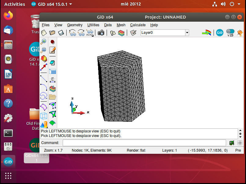

Re: GiD does not completely load at start
Have you tried with current GiD 15.0.1 version?
At least in our virtual machine with Ubuntu 18.04.3 x64 is able to run
