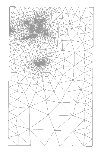

For the explanation about assigning mesh sizes near lines and points on a surface, I found some stuffs of my past work with GiD:
Screen Shot 2019-06-06 at 4.24.08 PM.png (38.43 KiB) Viewed 24003 times
Screen Shot 2019-06-06 at 4.24.18 PM.png (16.31 KiB) Viewed 24003 times
Screen Shot 2019-06-06 at 4.26.07 PM.png (14.7 KiB) Viewed 24003 times
I can easily figure out how did I make the points for assigning mesh sizes. By simply using the routine of splitting surface then did the way as the one which mentioned in the tutorial.
But sadly to say, I couldn't remember how did I make the line in a surface with GiD...
That seems I created two lines by several points and combined the lines with the NURBS surface as an inner boundary (now I couldn't understand why an inner boundary could exist without any connection with other boundaries, but obviously it worked with some way before...). May I know if you have any idea for the similar process?

a) z coordinate is extrapolated as you pointed, with a kind of weighted average of a cloud of closed points
b) There is not possible to have user control on the resolution the NURBS surface created, it is automatic, in any case it is only an approximation, does not fit the original points.
c) I don't know how have you created in the past the entities of the model of your pictures.
Maybe they were created from a triangulation, that wast tried to be converted in geometry using the tools like
Geometry->Create->Surf mesh (this create surf-meshes, that are GiD pseudo-surfaces with shape defined by a underlying triangulation)
or
Geometry->Create->Geometry from mesh->NURBS patches
both cases try to divide the triangles in parts, and create its points, lines and surfaces.
About creating curves on an existent surface, you can divide it in u or v parametric direction
Geometry->Edit->Divide->Surfaces
or create the curve by intersection with other auxiliary surface (e.g. some extra plane)
Geometry->Edit->Intersection->Surfaces
or
Geometry->Edit->Intersection->Surface 2 points
(this ask for 2 points on the surface, and create do do the intersection a 'virtual plane' with the points and a normal averaging the normal of the surface on the points)

Posts: 1961
Re: Why a NURBS surface always automatically rotates after being generated
The main problem of this model is the bad shape of some surfaces (like the surface 3246 of the 3volm_beforemesh.gid),
there are self-intersections of intersections with neighbor surfaces that prevent the creation of the volume mesh.
I attach some pictures of the problematic shape, and some mesh of these surfaces.
Surface 3246:
Surface mesh:
Detail of surface mesh:
About do slices to see the interior shape of a volume mesh, there are different tools:
