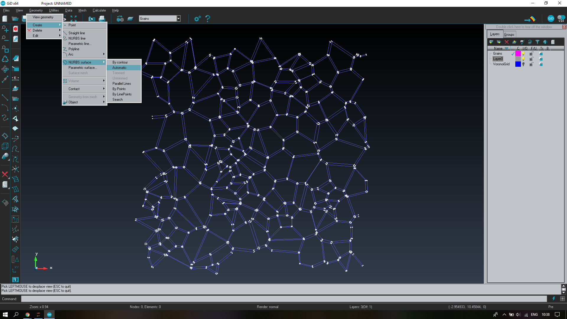

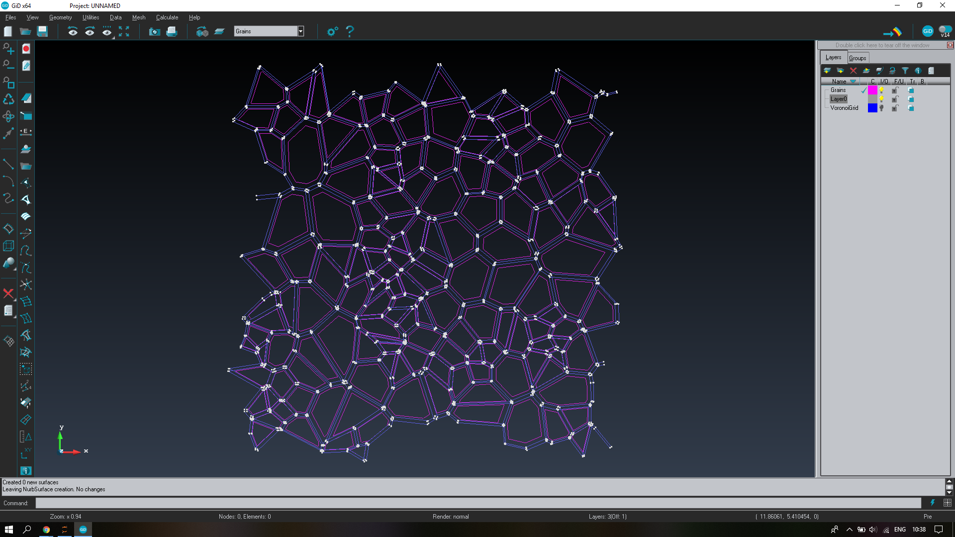

I am creating a Voronoi grid with separation (between the Voronoi shapes) through a batch file created by Python. After I import my batch file I end up with something that you can see in picture1. Then, I use the "Geometry Create NURBS surface Automatic" to create all the surfaces as it can be seen in picture2.
Since I want to do some other things to my project after that, I am trying to find a way to automate the process of creating NURBS surfaces through a batch file (i.e. through the command line).
