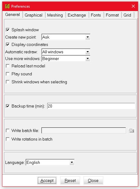

I searched for "Utilities->Preferences...
Post files->Use result cache" but I don't find it.
I attach the jpeg of the Utilities window

According to the GiD logo in the snapshot, I guess you are using a really old version (maybe version 7?). This option is in more modern versions.
Re: Problems with open .post.res file
Yes, I have 7.6.6 GID version
