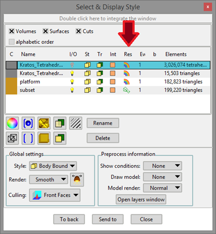

Re: Plotting results only on specific domain portion
Post by miguel »
Hi Carlo,
on the new version GiD 14, you can enable or disable the results visualization on each set independently:
You can download the latest GiD 14 version from here https://www.gidhome.com/download/official-versions/
