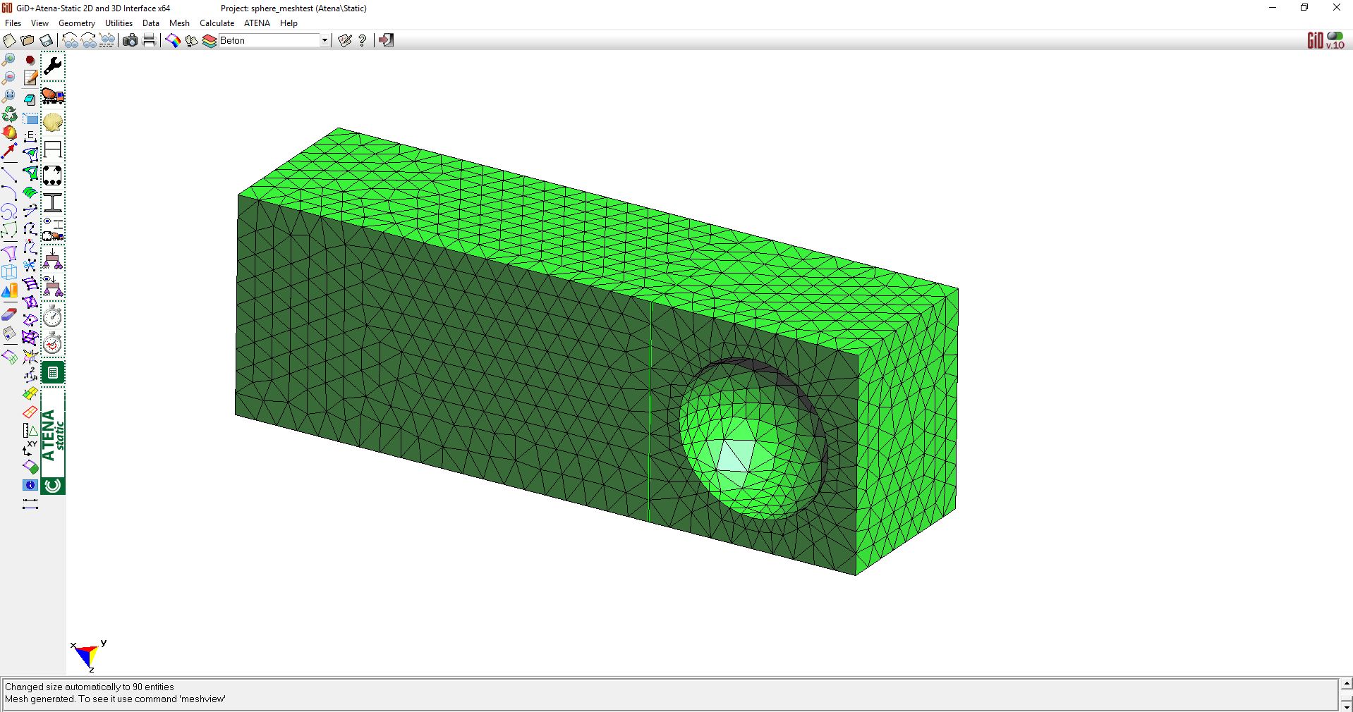

I'm working on a model regarding a structure with spherical voids. Now i'm wondering if there's a way to mesh parts of this model with a structured mesh. see the following figure and the attached GID file
sphere_meshtest.gid.rar
(1.22 MiB) Downloaded 684 times
According to what I have read til now, spheres can be meshed by tetrahedra's only. My goal is to create a mesh aproaching the given mesh in the following figure (created with another FEM package) where a structured mesh is used outside the area with the spherical voids

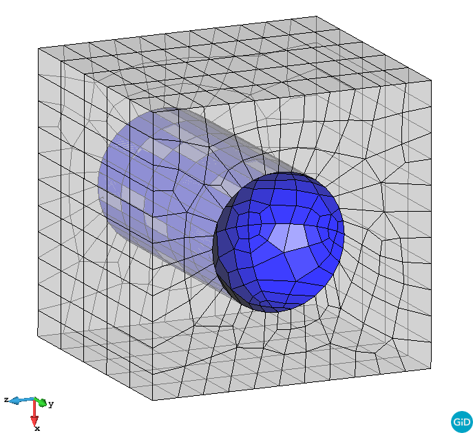

Hi, thanks for the quick response. I'm still wondering how the connection between the 'unstructured' part with spherical voids can be made with the structured or semi-structured part with hexahedra elements. In the attached image the two volumes (4 and 5) are given wherein surface '2' is shared. When the hexahedra type is choses for the prismatic part (volume 5) an error, regarding incompatibility is given.

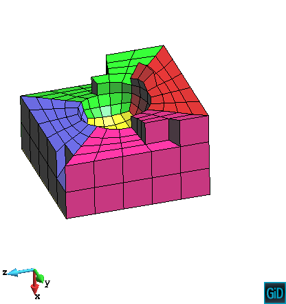

It is possible to create and mesh with GiD a geometry like your first image, but split the volume around the sphere hole into structured (6 faces block-like) could be hard to do.
I attach the zipped GiD example
StructuredSphereHoledCube.zip
(77.82 KiB) Downloaded 675 times
of this picture
(some hexas were deleted to see the interior)
But it is not possible to do the same for the model of your second image.
This is because structured meshes are not used for complicated geometries. Unstructured meshes of triangles/tetrahedra are much powerful.
Re: Sphere meshing
About your last questions, GiD doesn't allow to create the mixed mesh of unstructured tetras and structured hexas because as you pointed are not compatibles in the shared surface (one has triangular faces and another quadrilaterals!!).
You can do all unstructured, or at least force the structured mesh to be automatically splitted in tetrahedra.
Mesh->Element type->Tetrahedra
and select the structured volume.
Then the whole mesh will be of tetrahedra.
