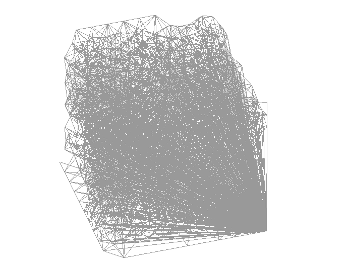

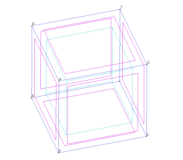

I am a new user for GID and, now studying the Tutorial.
I have a problem during studying the Tutorial.
I dont know why it happen even I follow every step in the Tutorial.
The geometry view is as same as shown in the Tutorial, but the mesh is wrong.
Could anyone give me a suggestion for this problem?

Try re-opening the file, How look the mesh then?
(without re-mesh, in some case seems that the mesh really is internally ok, but its representation inside the graphic card become wrong)
Check also that do you have only a volume, maybe there are more than one with the same surfaces as boundary

Oh, It seems to be o.k. after re-opening the file.
Thank you very much for your suggestion.

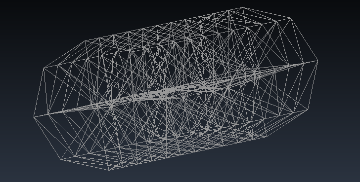

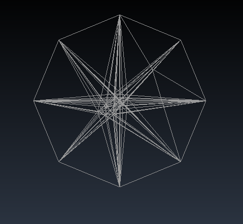

I try to follow the instruction, but sometimes the error was found after I generated mesh. (please see the attach file)
In my opinion, the program should automatically generate the uniformly and symmetry mesh. (my opinion may be wrong)
So I would like to ask you that in case I did some thing wrong during drawing the model, which cause the wrong mesh generation.
What should I do? can I correct the model without re-drawing.

The problem of show just after mesh a wrong mesh, like your initial picture (where seems that some nodes are in a wrong location)
only happen in some rare case and never happened in our machines.
It is a graphic problem, the mesh and the node coordinates are ok, saving and opening again the mesh is refreshed ok in screen also.
It seems a problem with a combination of graphic card+driver+GiD version+Open GL options used
I suspect that is related with Vertex buffer objects and Vertex array methods, where coordinates are copied to the graphic card memory to accelerate drawings,
try changing Utilities->Preferences... Graphical->System->Method: Display lists or Immediate
and maybe is not happening in latest GiD versions (you can try last the 13.1.11d developer version)

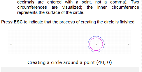

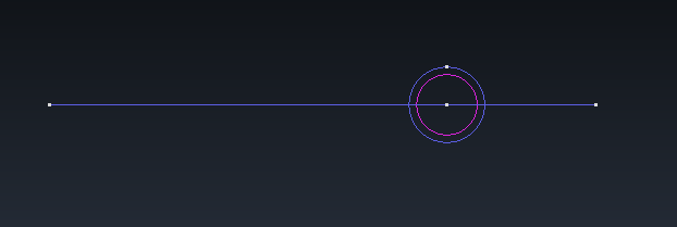

I also tried to install the 13.1.11d developer version, but the result after I used intersection tool, the result of 13.1.11d developer version is not as same as shown in the tutorial (the point on the circle). So I did not continued the drawing (see the attached images)

About your last pictures: The tool that create a circle has changed in latest GiD developer versions, now the starting point of the arc is on the upper point, in previous versions will be on the right of the circle.
The tutorials are related to a GiD version, doing the same with other versions could have some difference.
