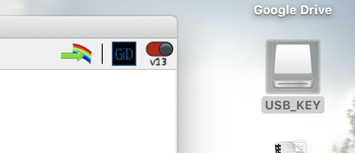

Yes, when I go to "Register GiD" memory stick and sysinfo is showed.
I think that the problem is in new macos, because it worked fine on Mojave. The files on licence USB are somewhat shaded, like they are hidden.
No problem under windows environment, and I did not have an opportunity to try on Linux.
One more thing that came to my mind is that the USB for licence key is not supported, but then it wouldn't work in windows OS.
I have attached print screens from both winos and macos.
- macos screenshot
- Screenshot 2019-11-21 at 12.11.06.png (173.59 KiB) Viewed 36024 times

Re: USB license of MAC
check if the information (name and sysinfo) that appear in Help->Register GiD... for the memory stick is exactly the same in both platforms (Windows and macOs).
