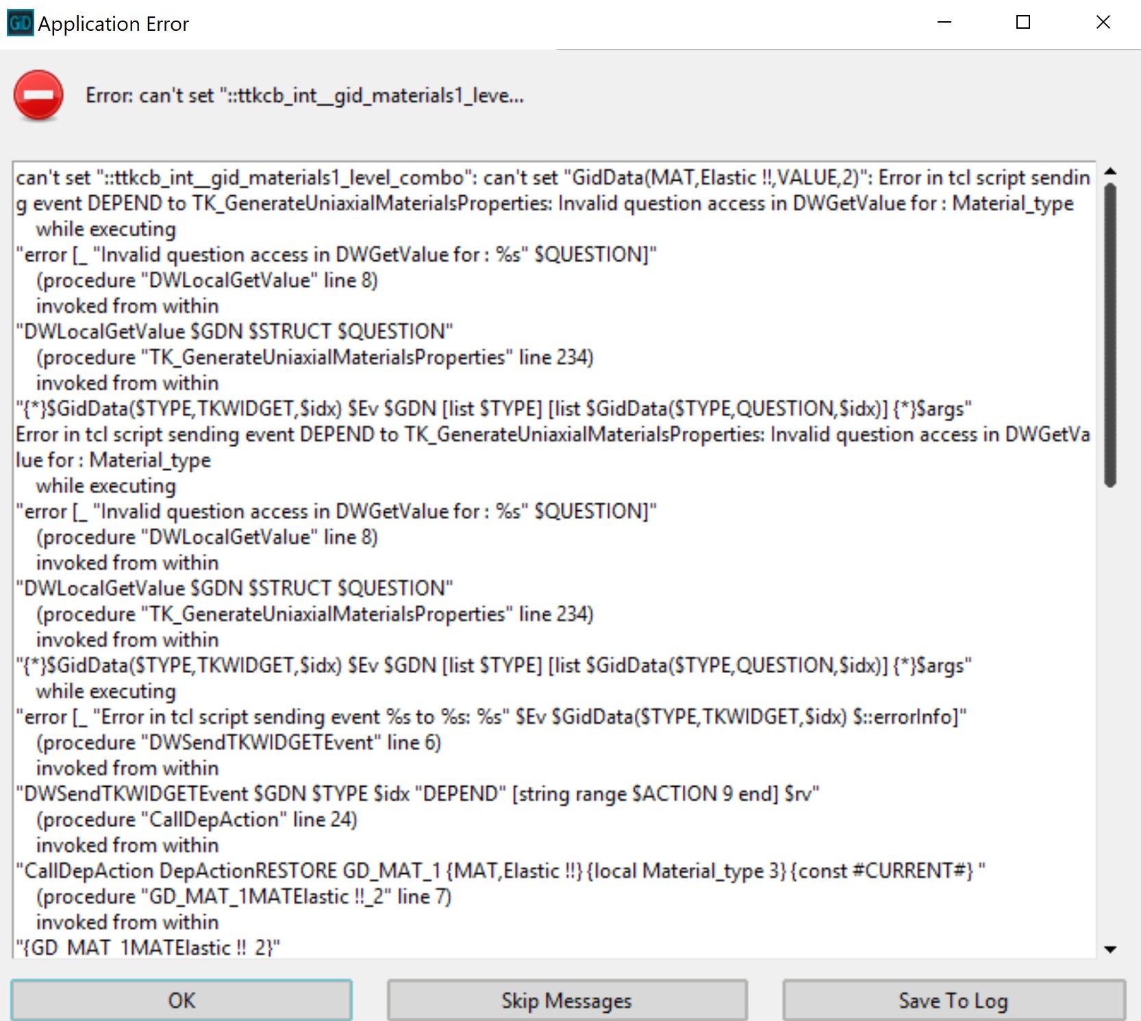

In some cases, i need to use tkwidget DWLocalSetValue to change the value as well as the state of some fields in order to handle field dependencies.
But i have observed that, when using it to change the state, when i create a material which consists of spaces as well, an error is occured. At the beginning the window is frozen, and when i reopen it, the following message is displayed:
Error message:
Any ideas how to fix it?
Thanks in advance.

I refer to OpenSees problemtype for some materials, such as Elastic, Elastic Perfectly plastic and more. This error is occured when i make a copy of the template material with a name which contains spaces (e.g. "Elastic E=30GPa" : copy of "Elastic"). This happens in every material that use a tkwidget and inside the SYNC event is used the tkwidget TK_DWSet for changing field value and state too.
TK_DWSet is actually a copy of DWLocalSetValue: just changed the variable "$state" to "$STATE" in line "$action($STATE) $GDN $STRUCT $ifld $VALUE" because with DWLocalSetValue it was returing error.
Although, without spaces in the name, it works fine.
