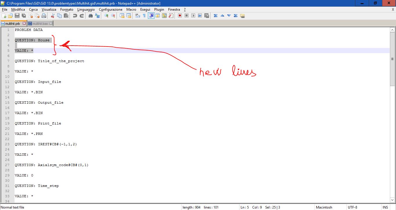

I want to modify an existing and working problemtype. I try to do it but I have some trouble. In particular I modified the .prb file simply by adding these two lines under the PROBLEM DATA statement:
QUESTION: request_param_A:
VALUE: *

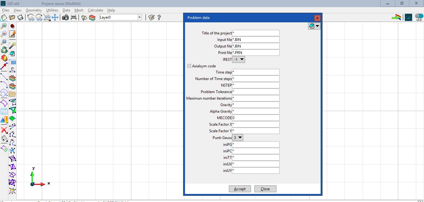

After, I open GiD13 and I select the problem type. Then I open Problem data but no field "request_param_A:" is added to the previous.
What should i do in order to get simply a new field?

I'm sorry, I try to apply all your suggestions but really I can't to obtain the result that I hope.
If you want i can send you the file .prb.
I have attached two image related with the problem I explained before.
Thanks for your help, I don't understand what's wrong.
- 2.JPG (89.3 KiB) Viewed 5349 times
- 1.JPG (101.66 KiB) Viewed 5349 times

I save a new project in GiD with old ProblemType. Then I open the folder of the new project and I open the .prb file. In that file I put the same change that I explained in the previous post. Finally I copied .prb file from the new project folder to ProblemType foder (in GiD progam folder). Then I opened Gid and I applied the new ProblemType to a new file and finally it worked well. I don't understand how it's possible but I'm happy. Thank you
