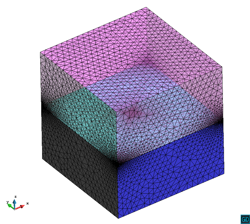

I'm sorry for so long to reply to you, I have solved this problem, and now, I have a new problem. I want the grids from the center of model(0,0,99800) to outside gradually become sparse. but at the points of the four corners of the middle cube, the grids is not encrypted. how to achieve it.

Force a small size in the interior of a surface or volume is difficult.
You can somehow split your geometry in several parts to have, to have some points and lines to assign them your desired sizes and then have more control on the mesh sizes.
And do you have a thin volume that force small sizes of its tetrahedra.
I attach your model modified concentrating some elements near the center (after divide some lines and assign them mesh sizes) For simple shapes you can also try structured (6-sided volumes) or semi-structured meshes (prismatic volumes)
