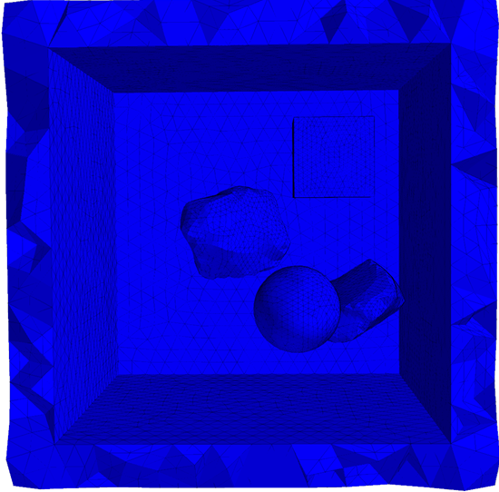

I've tried to create a bucket in a rectangular form and trying to assign it as a tetrahedral mesh. while no matter how many times i tried, once the bucket layer is under impact, the layer will deform or wrap on the particle that impacts on it.
How can i fix it? can anyone teach me on this issue?
Thank you soooo much
one screenshot for a bucket that should be created is been attached, which I got from a third party.
how to create a rectangular bucket in 10-node tetrahedral format?
- bucket example.png (265.77 KiB) Viewed 8306 times

If I have understood well do you want to create a volume of a rectangular bucket and mesh it with quadratic tetrahedra.
for example I have created it creating first the surfaces of the base, a rectangle and a ring around the rectangle, and then I have created volumes by two copes with extrussion along z.
Then to mesh the volumes with quadratic tetrahedra must set Mesh->Quadratic type->Quadratic
and generate the mesh with a general edge size.
I attach this simple model that looks like this picture

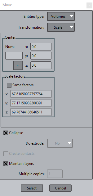

Yourself could create my geometry easily, simple create in 2D the two surfaces of the rectangle and the ring around it, and use the copy tool do do a couple of extrussions to create the volumes.
Please, follow a GiD tutorial like the ones of the 'GiD user manual' to learn about start using GiD.
(this is a link to the pfd version ftp://www.gidhome.com/pub/GiD_Documenta ... Manual.pdf, they are also included in the GiD help in html)
You can also try to modify my previous file using the Move - Scale tool to resize the volume scaling with different factors on each x y z direction
Utilities->Move...
Entities: volumes, Transformation: scale, and set the three appropiated factor to get the desired sized
measure the current size with Utilities->Distance)
e.g. my model has sizes 2.95812x2.59163x4.3 units, to have 200x200x300 the scales must be ex=200/2.95812, ey=200/2.59163, ez=300/4.3 I attach again the model scaled
Utilities->Move...
