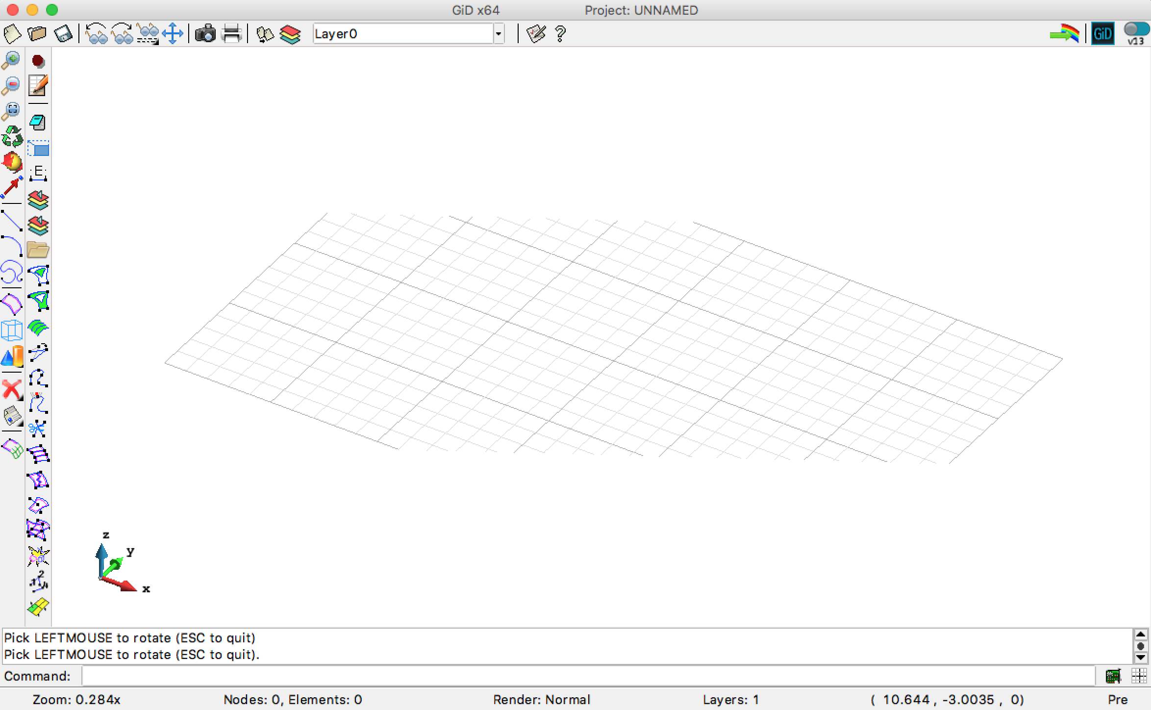

Hi, on my mac, after installation, when i start drawing, or rotating the grid, part of it is not shown.
Part of other entities are also not shown (lines, surfaces, meshes) etc..
How can i solve this ?
Marco

I think that it is only a problem with the 'visualization box'. Rotating the model some part could become outside this visible region.
You must simply do for example a 'Zoom Frame (e.g. menu: View->Zoom->Frame) and this bounding box will be recalculated.
