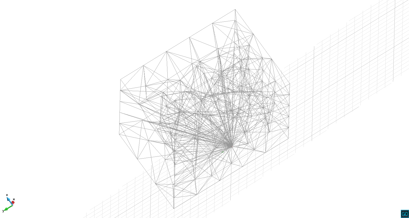

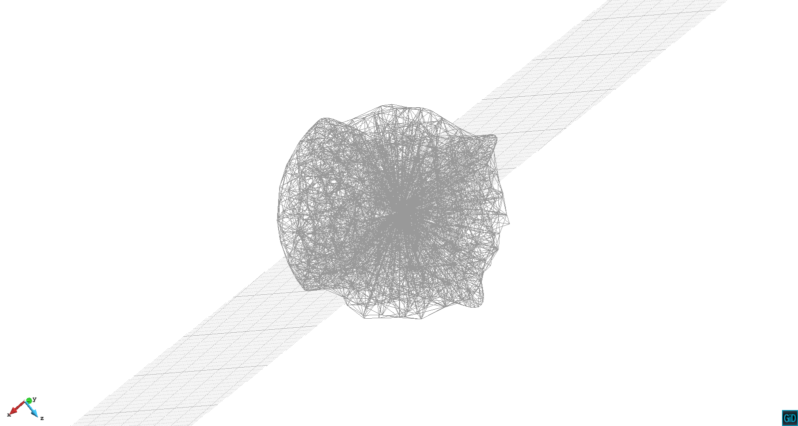

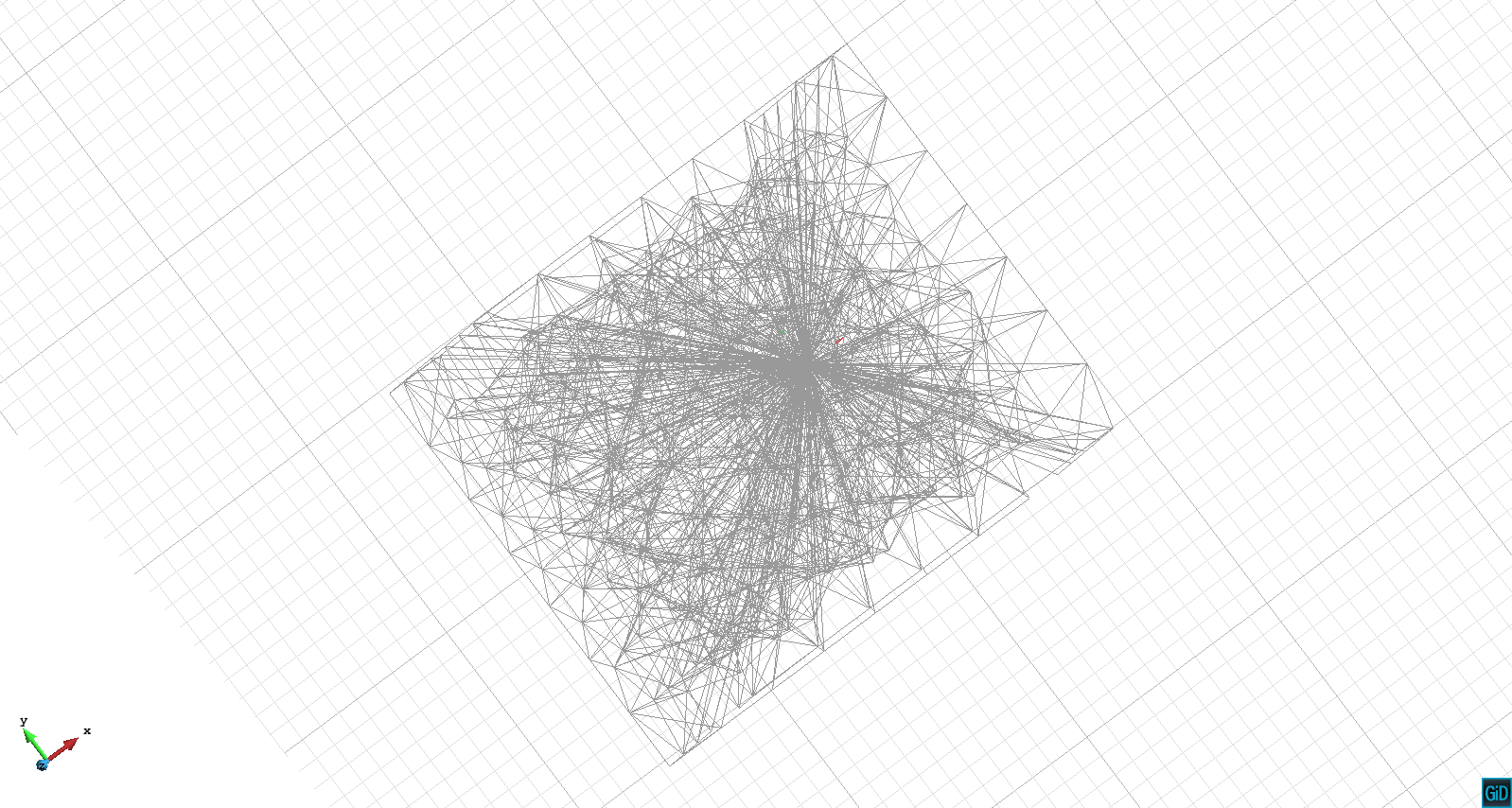

The result of mesh is obtained when I generate mesh for the cube volume.
I thank the situation is bad .
A bug of the gid V13???
or
There are some wrong of my operation!!!
please help me?
or
please help me?
- meshofcubewhy.png (111.9 KiB) Viewed 13618 times
- meshofcubewhy_0.png (126.45 KiB) Viewed 13618 times
- meshofcubewhy_1.png (208.79 KiB) Viewed 13618 times

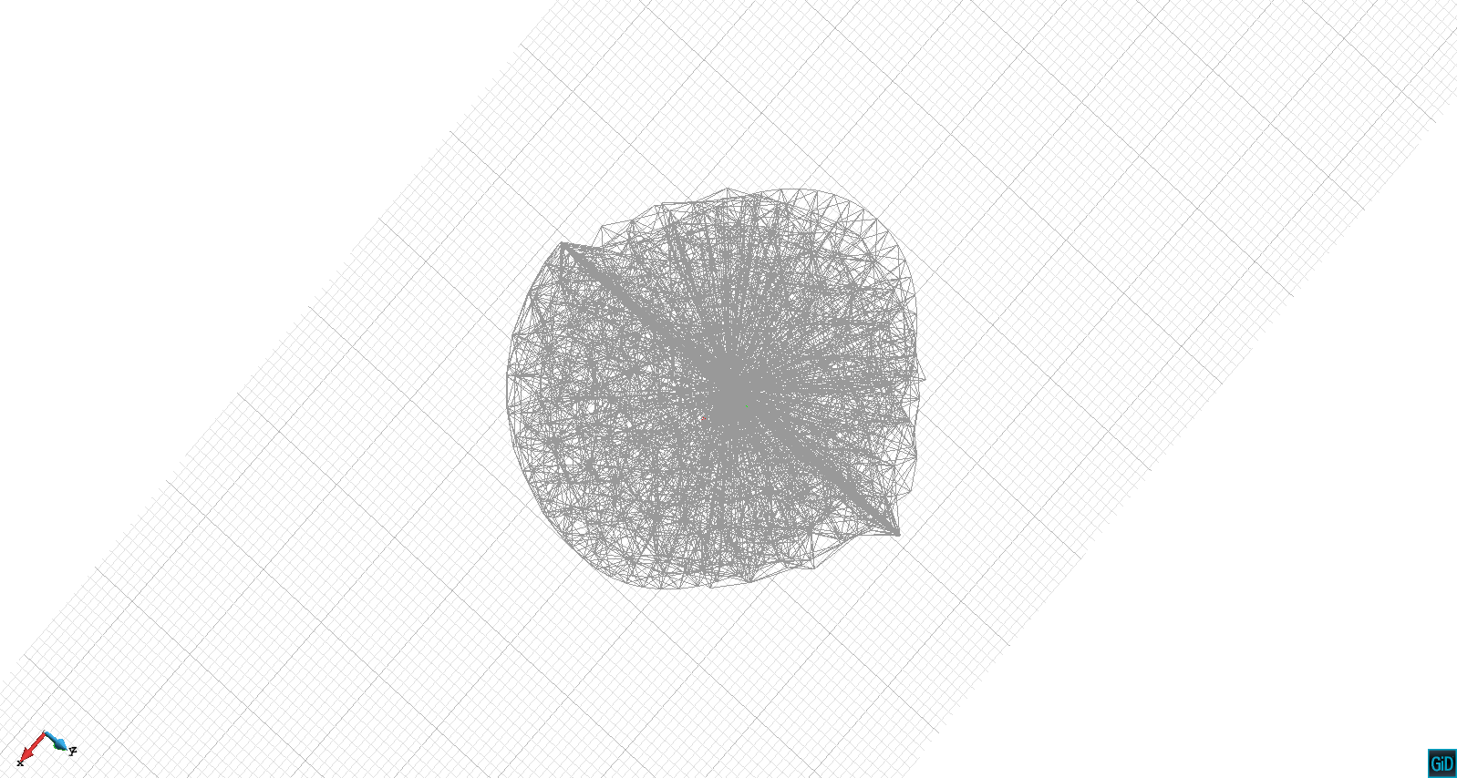

Bug or other
the same to cube volume
- meshofsphere.png (174.18 KiB) Viewed 13610 times
- meshofsphere_0.png (87.14 KiB) Viewed 13610 times
- meshofsphere_1.png (89.98 KiB) Viewed 13610 times
Re: Bug ?about gidv13!!!! please!!
Please, attach a zip with the GiD model

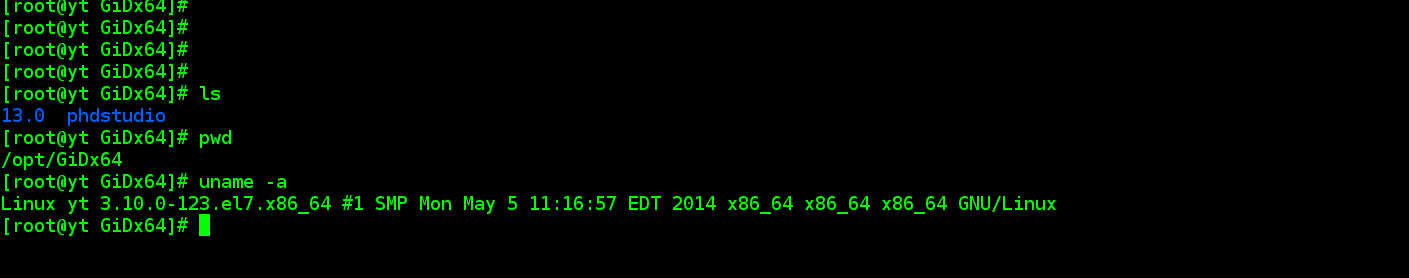

gid boot informationScreenshot from 2016-07-11 22:38:01.png
my os is redhat enterprise linux 7 64bit
Ok, thanks for the information.
The attached models themselves are ok (I have read them with GiD 13 win x64 and everithing is correct)
Then seems the problem with dependencies of some library on the Linux x64 version running GiD without OpenGL harware acceleration (gidx) and maybe anothe kind of problems with graphics/drivers with the graphical acceleration on (gid)

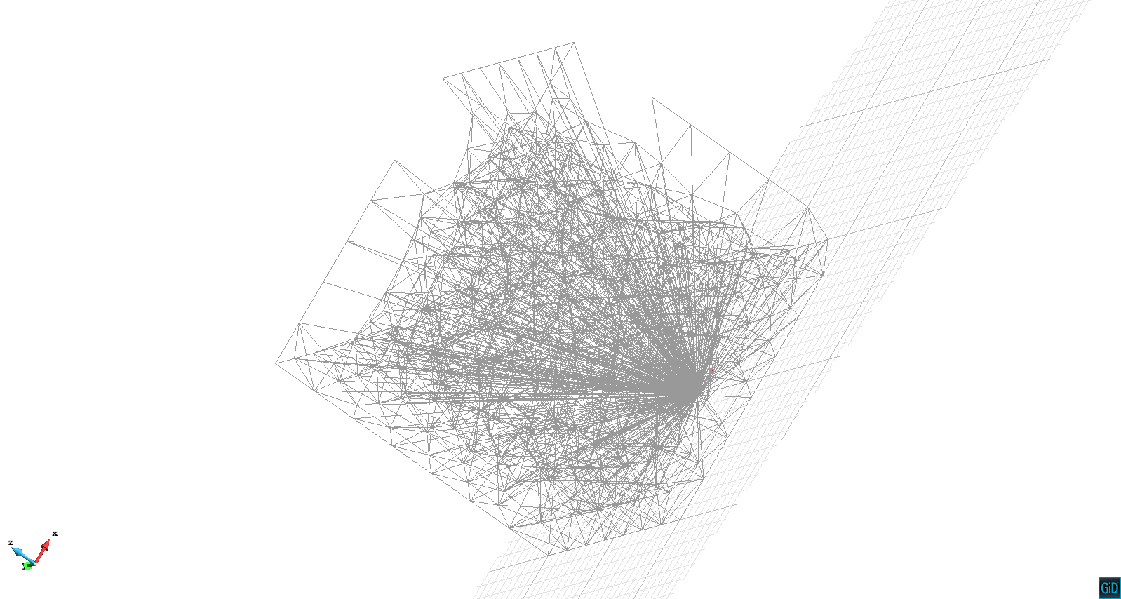

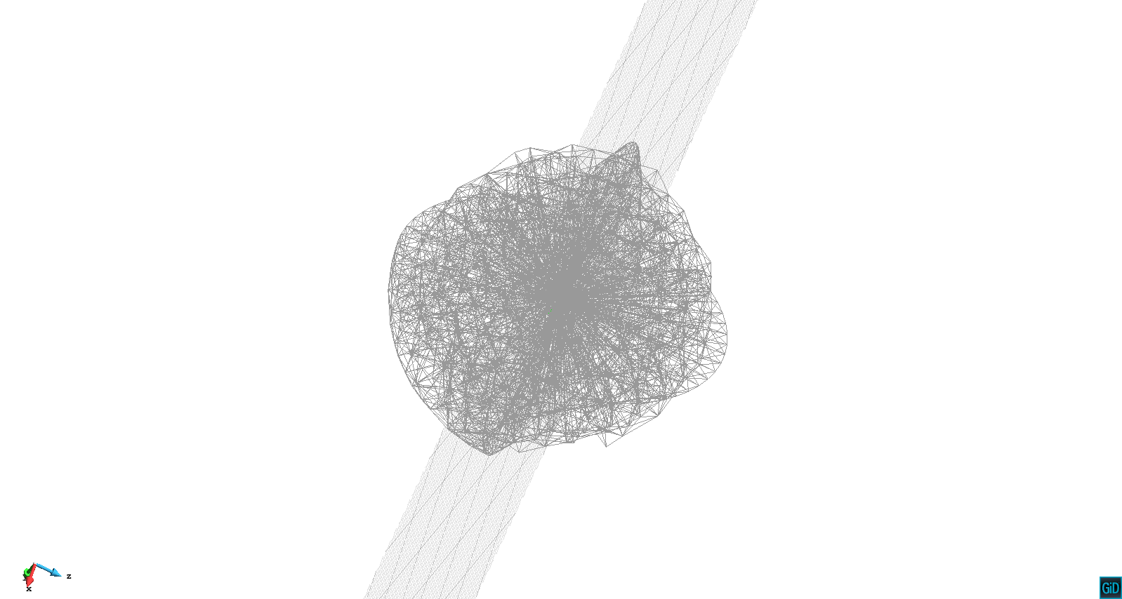

Dear sir:
The bug (maybe) is existed always on the linux os platform.(redhat enterprise linux 64bit)
Would you please solved it!!!
thanks.
yours friend zyex1108
thanks.
- bugreport.gid.tar.gz
- (70 KiB) Downloaded 925 times

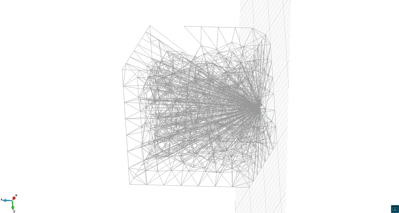

the view map
- Snapshot.png (103.27 KiB) Viewed 13593 times
