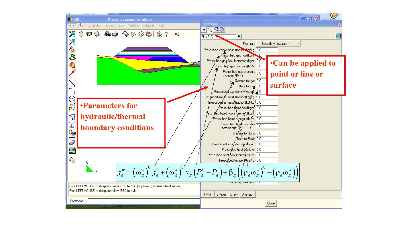

I am posting a couple of slides explaining the leakage coefficient. About the units, Code_Bright uses the International System of Units (SI): kg,m,s... with the only exception of pressure, which is expressed in MPa.
Alfonso
Alfonso
