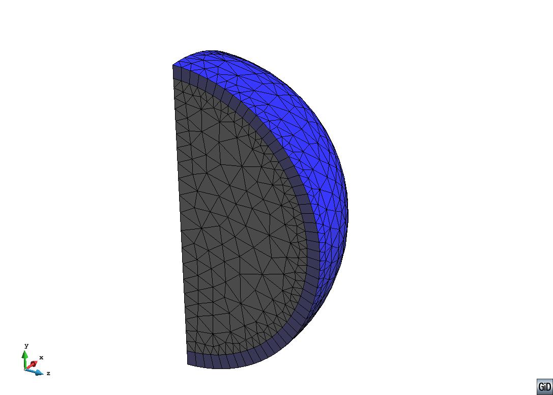

Dear Colleagues,
I do an attempt to generate a single layer mesh of 6-nodes prisms
on an unstructured tet-mesh. This is to have single layer
of shb-type shell elements covering the tetrahedral mesh.
Therefore, I generated a quarter of a sphere (volume to be
meshed with the first order tets) an a "skin" of a 3d-layer
(volume to be meshed with the 6-nodes prisms).
However, I am not successful at all, but it looks
it should be possible.
Could give any advice ?

Re: prism+tets
the prism elements can only be obtained from a topologically prismatic volume. Can you send me the model in order to allow me to check whether the geometry fits with this requirements or not?
Re: prism+tets
If do you already have created the 'ring volume' to be meshed with prisms, and this volume is topologically two similar tops, connected by lateral four-sided surfaces,
(you can create this volume for example form the copy window, with a offset of surfaces extruding a volume, or in the particular case of a sphere instead an offset operation a scale could be used. Offset is an approximated operation, scale is an exact geometrical operation)
then you could mesh this volume semi-structuredly.
Mesh->Semistructured->Volumes
select the volume (the ring) specifying the amount of divisions in the structured direction (1 in your case)
Mesh->Element type->Prism
and select the volume (by default volume elements are tetrahedra)
GiD will try to automatic detect the semi-structured direction (and select a master-surface), in case of doubt or ambiguity you can splicitly set the direction with
Mesh->Semistructured->Set->Structured direction
or alternativally set the master surfaces of semi-structured volumes
Mesh->Semistructured->Set->Master surface
GiD could also create boundary layer meshes, without require any geometrical modification,
Mesh->Boundary layer
This allow create very thin elements close to some boundaries (but they will be tetrahedra also, no prisms), setting the amount of layers and its sizes following some law.

Re: prism+tets
I attach your model, reseting all your mesh data and settign the ring volume as semi-structured with tetras
Mescape Geometry Create Reconstruct OneSurfForEachElement
probably is because your GiD version (see Help->About) is not modern enough and the command doesn't exists
It exists in last developer versions (current is the 12.1.7d)
About the message "Reconstruct - unknown command" usingMescape Geometry Create Reconstruct OneSurfForEachElement
Re: prism+tets
Thank you for the model. It helps a lot.
Let me ask:
Is there a way to generate a very thin layer of prism
(they are shb-shell like elements, 6 nodes)?
Supposing, the radius of a sphere is 0.5m,
and the thickness of the layer is 3.0e-04m.
The layer covers the sphere that is
discretized with unstructured tetrahedra,
and the prisms match the discretization of the sphere.
regards,
Elek
Let me ask:
regards,
Elek
Re: prism+tets
It doesn't matter if the tickness of your ring is small, it it the same case that I explained.
e.g
create a sphere r=0.5 and create the ring volumes with a copy of surfaces with scale=1.0006 (1.0006=0.5+3e.4/0.5) extruding volumes.
(simple be careful to not to set the 'collapse' checkbutton of the copy window, to avoid join again the close entities)
and set the ring volumes to be meshed semi-structured with 1 division and to be meshed with prisms.
e.g
