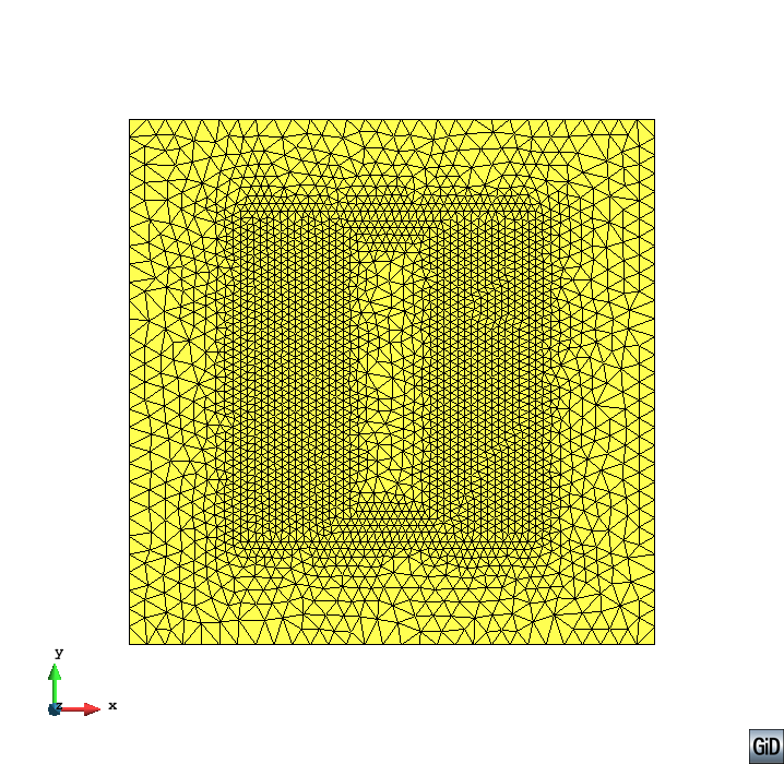

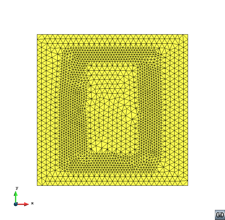

I am currently evaluating GiD to potentially replace our current meshing software. My company develops and maintains an electromagnetic solver that has a range of meshing challenges to optimize the problem.

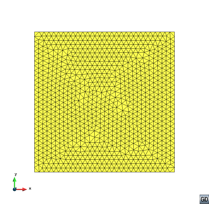

In the example posted an element size range has been specified, a size gradient, and a geometrically adaptive function for all surfaces. The function places a bias away from lines. Does GiD have any adaptive features that could reproduce this or is there a work around to get close? The closest I have gotten was by building new geometry and setting sizes on each surface. My attempt with preferences is also posted. Another way to apply this type of thing after mesh generation would be somthing like refine the mesh X times with Y bias around Z line.
Objective mesh
Objective mesh
GiD Attempt
GiD Attempt

Re: Biasing in Unstructured Meshes

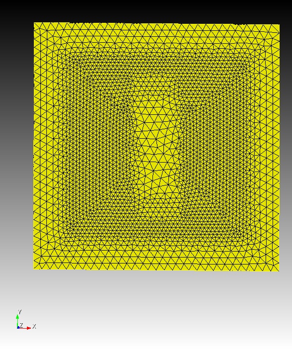

With GiD you could assign sizes only to geometrical entities, then is not possible to localize a finer mesh in some inner part of a surface.
To do it is necessary to modify the geometry, adding more entities to assign sizes.
for example to have a mesh similar to your picture in a 1x1 square surface I had to split the surface, and assign size to the points, lines and or surfaces.
e.g spliting in two parts the square, and assigning size 0.015 to the inner lines and points, and general size=0.035

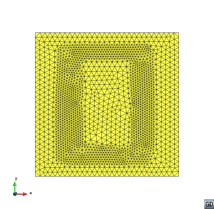

mesh
mesh
or splitting in three parta, and assigngin size 0.015 to the inner surface, lines and points, and general size=0.035

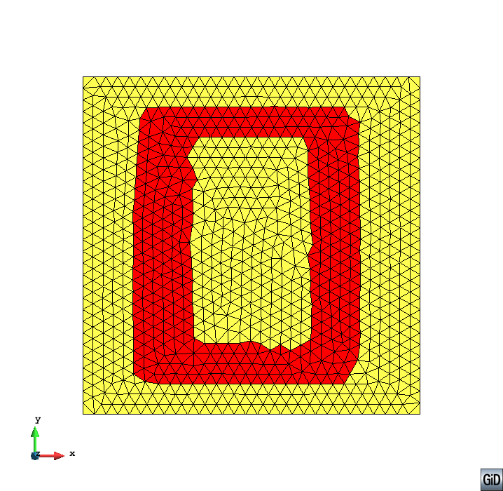

About the approach or 'refine the mesh' it is possible to do it, selecting the triangles to be splitted:
Mesh->Edit mesh->Split elements->Triangle - Triangle
and select the triangles to be splitted
elements selected
elements selected
mesh after split selected triangles
laplacian smoothing of the final mesh
This woks, and also the conditions and materials of the original triangles are inherit by the new triangles, but direct modification of the mesh is not the recommended way to work with GiD (for example the manual selection of the elements can't be exactly repeated).
The normal way is to apply everything to the geometry and then generate the mesh.
