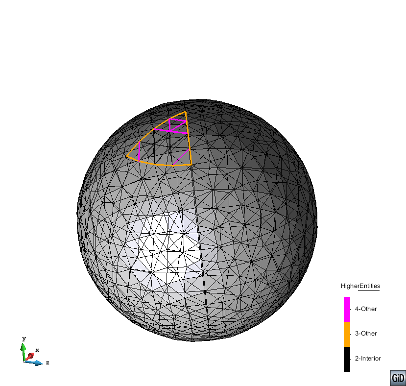

Your initial mesh has a portion of the sphere duplicaded, with overlapped triangles.
Using View->Higherentites->Edges
you will see the part with a repeated sector:
You could manually delete the unwanted triangles before the conversion to surface, or delete the surfaces after the conversion.

Thank you, it was an error in patran
geometry "duplicated durface"
