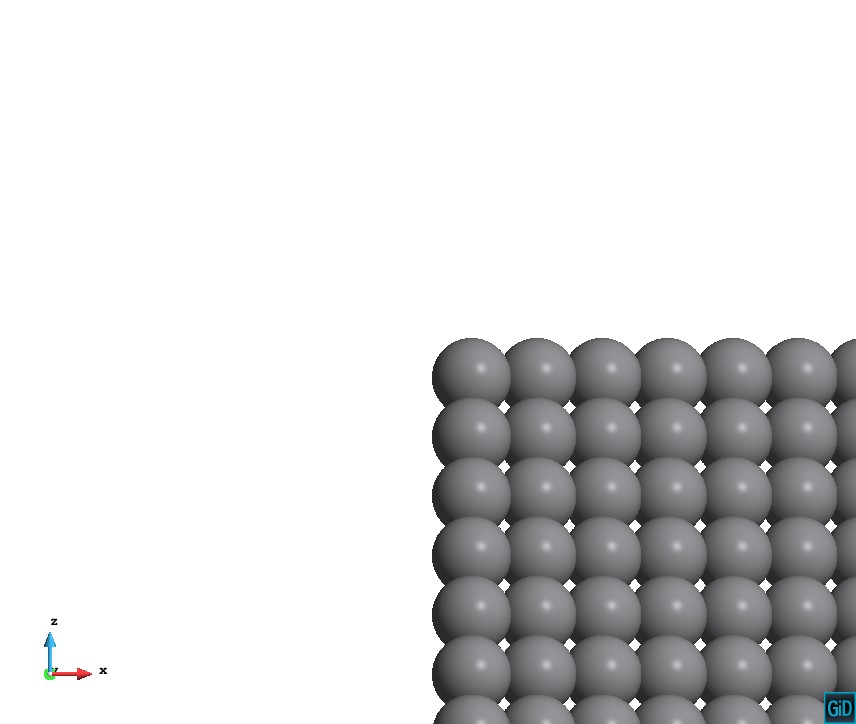

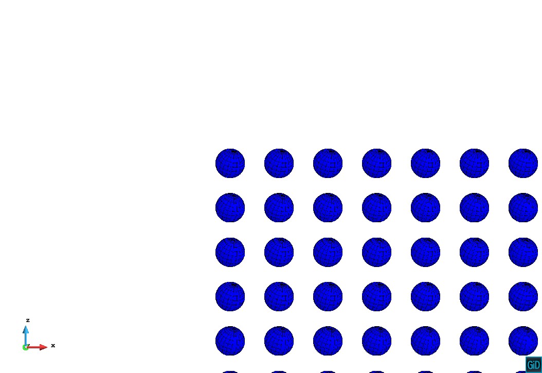

Dear Colleagues,
Could you be so kind to tell how to make
the sphere elements to be the same visual dimension
in case of pre- and post- processing?
This is the problem of the dimensions.
I attached 2 figures, the first is from
'import gid mesh' and the second one just opened in
the post-processing mode.
Thank you, best regards,
Elek

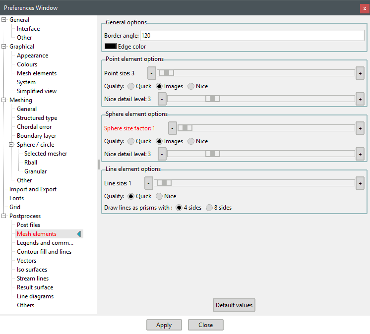

Re: sphere_els_pre-pro-visual
Utilities->Preferences... Postprocess->Mesh elements
