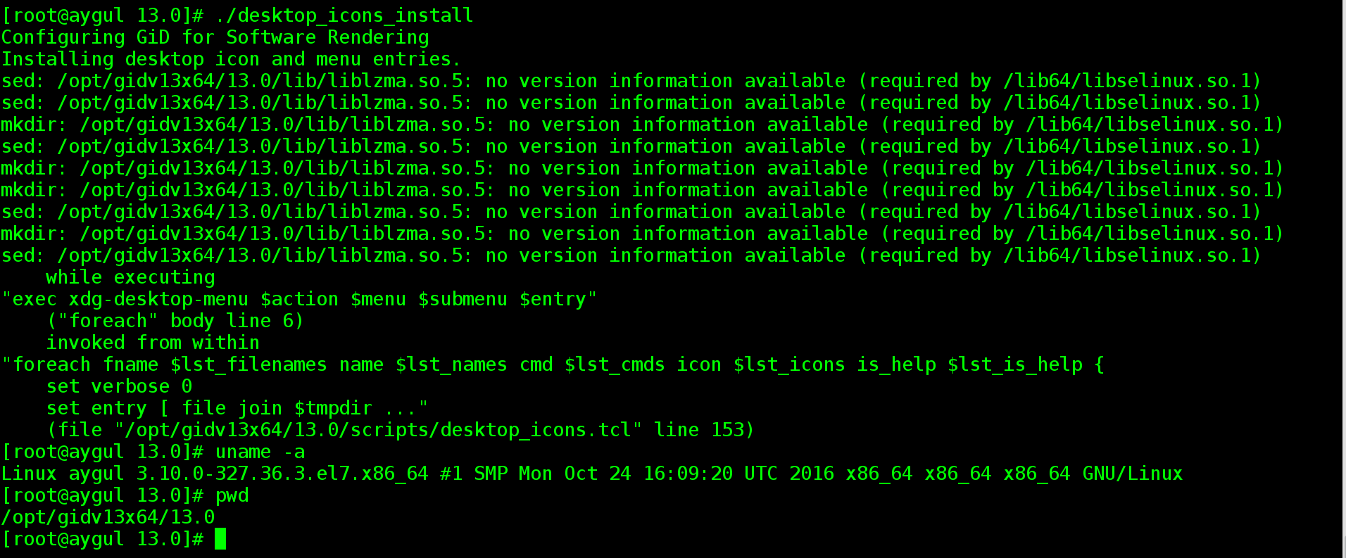

my os platform is centos 7.3 x_86_64.
why????how to solve this problem? thanks!!
Screenshot from 2017-03-01 15-31-43.png (137.25 KiB) Viewed 12681 times
