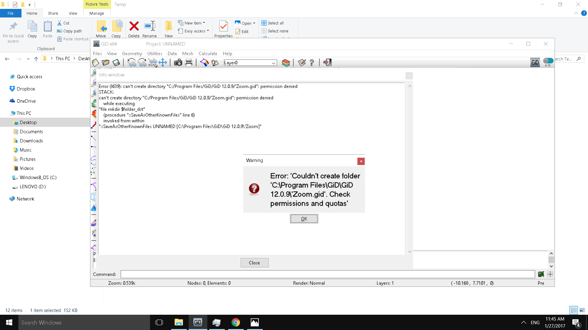

Furthermore, if I try to zoom out using the mouse wheel during this "freeze", the following errors appear (also attached for clarity):
Error (l639): can't create directory "C:/Program Files/GiD/GiD 12.0.9/'Zoom.gid": permission denied

There is also this warning:
Error: 'Couldn't create folder 'C:/Program Files/GiD/GiD 12.0.9/'Zoom.gid': Check permissions and quotas'

- Problem.JPG (15.99 KiB) Viewed 5108 times
- GID error more clear.png (156.43 KiB) Viewed 5108 times

is because your mouse events try do do a zoom of your model that are misunderstood as the name of the model that you want to write.Error (l639): can't create directory "C:/Program Files/GiD/GiD 12.0.9/'Zoom.gid": permission denied
