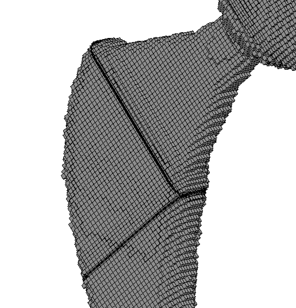

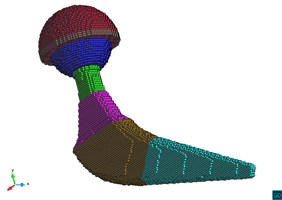

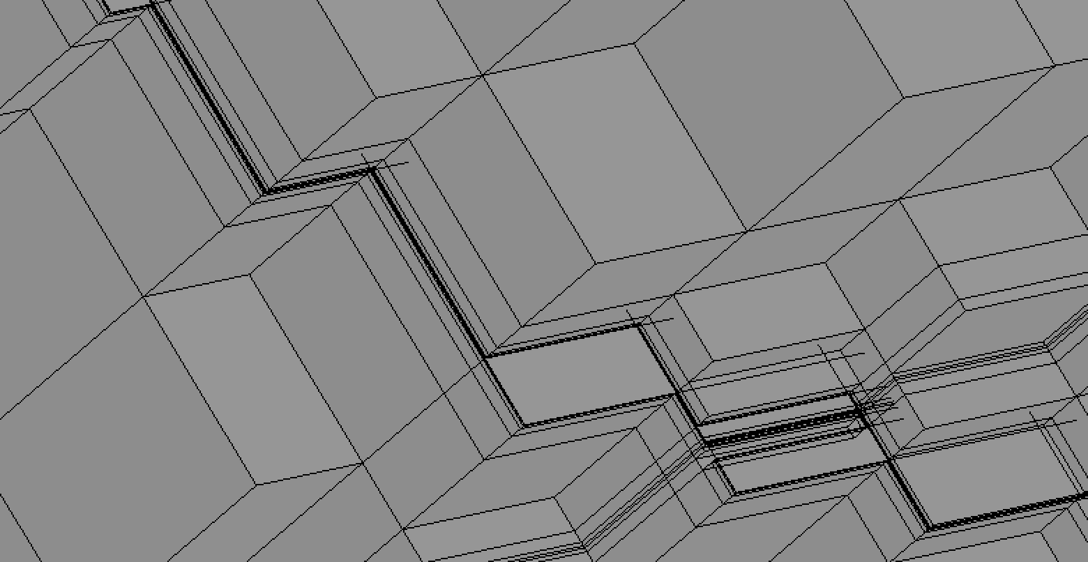

I'm working with a hip implant that I've imported in .stl format, I need to get a cartesian mesh of it with exactly the same element size in all directions. I correctly assigned cartesian mesh to my volume, then I meshed it, but when I was evaluating the mesh quality I realized that many of the elements have a poor shape quality, what means that my bricks don't have the same length in all directions. How can I solve it? It is really important to get bricks with the same size and the same element edge length in all directions.
Captura de pantalla 2016-11-08 a las 11.41.16.png (174.81 KiB) Viewed 7858 times
If you take a look at the program help and type 'cartesian mesh', it shows you that you get bricks with equal size, I don't understand why it happens. I've attached some screenshots to show you what I'm talking about.

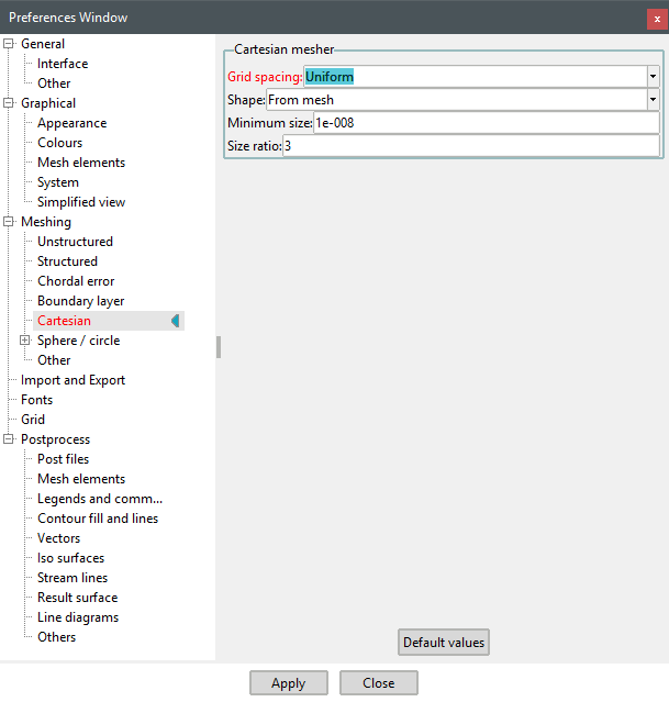

In Utilities->Preferences... you must select 'grid spacing' as Uniform

Thanks for replying me! I've tried to do that and meshed it again. In fact, I've tried to specify a minimum size in preferences window too, but the problem is still there. Is there any other solution?

This is how the mesh look like
