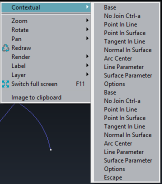

In any case, about the cuestion of 'divide a line near point', it require a coordinate that could be not on the line to be divided, and GiD will find the nearest point on the curve and will divide it.
In is not compulsory that the 'near point' is an existent point, if fact only the coordinates are required. While selecting you can select some existent point (picked in screen or entering its id) or a new coordinate (picked in screen or entering its x,y,z real numbers).
Also in the contextual menu could select other options, like 'point on line' to pick a point on an curve, etc.
