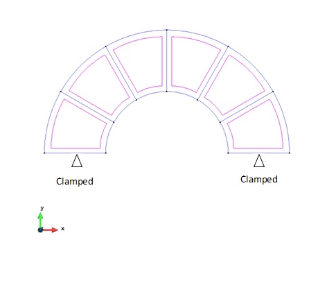

- Half part of the segmented ring
Condition -> displacement -> y-axis -> clamped
This condition is to be given to the geometry, such that GiD considers the complete ring by translation symmetry - p1.jpg (22.41 KiB) Viewed 10462 times

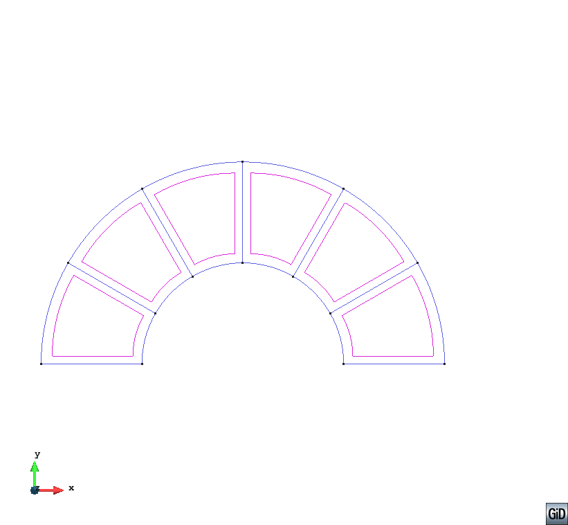

- 2 segments of the ring
What condition to be given for the end lines such that GiD considers the complete ring by symmetry?
This is to reduce the problem size and run time. - p2.jpg (9.94 KiB) Viewed 10462 times

Re: cyclic or circumferential symmetry
Hello Mr. Escolano
am again stucked with the same problem of how to get full segmented ring performance by modelling two segments only. watever u have suggested in the last post i have tried everything. but i couldn't get it.
we are using ATILA problem type as a solver and doing structural analysis. In this problem-type, for translation symmetry and to avoid structural translation displacement we will be giving the condition
displacement -> clamped -> along required axis assigning condition.
so can u please help me in assigning condition for two segments such that it takes radial symmetry and also the structure should not displace from its position.
Re: cyclic symmetry
In fact, I think that probably you cannot simulate the full ring only with one or two segments, by symmetry,
because to do it not only the geometry must be symmetric, but also all boundary conditions and forces must be symmetric!!
e.g: a pipe with inner pressure is a revolution-symmetric case.
I think that your case does't has symmetry because of your clamped displacements (you said nothing about applied forces, are they also symmetric?)
I had a look to the problemtype Atila 3.0.27 and it has a condition-line displacement that could be set in each direction x y z to a forced value or to clamped (value=0), but it seems that is only allowed in global coordinates, not in local coordinates (e.g. to fix the movement along the radial or tangential directions)
In any case this is not a question to be asked to this GiD forum, it must be asked to the Atila developers.
