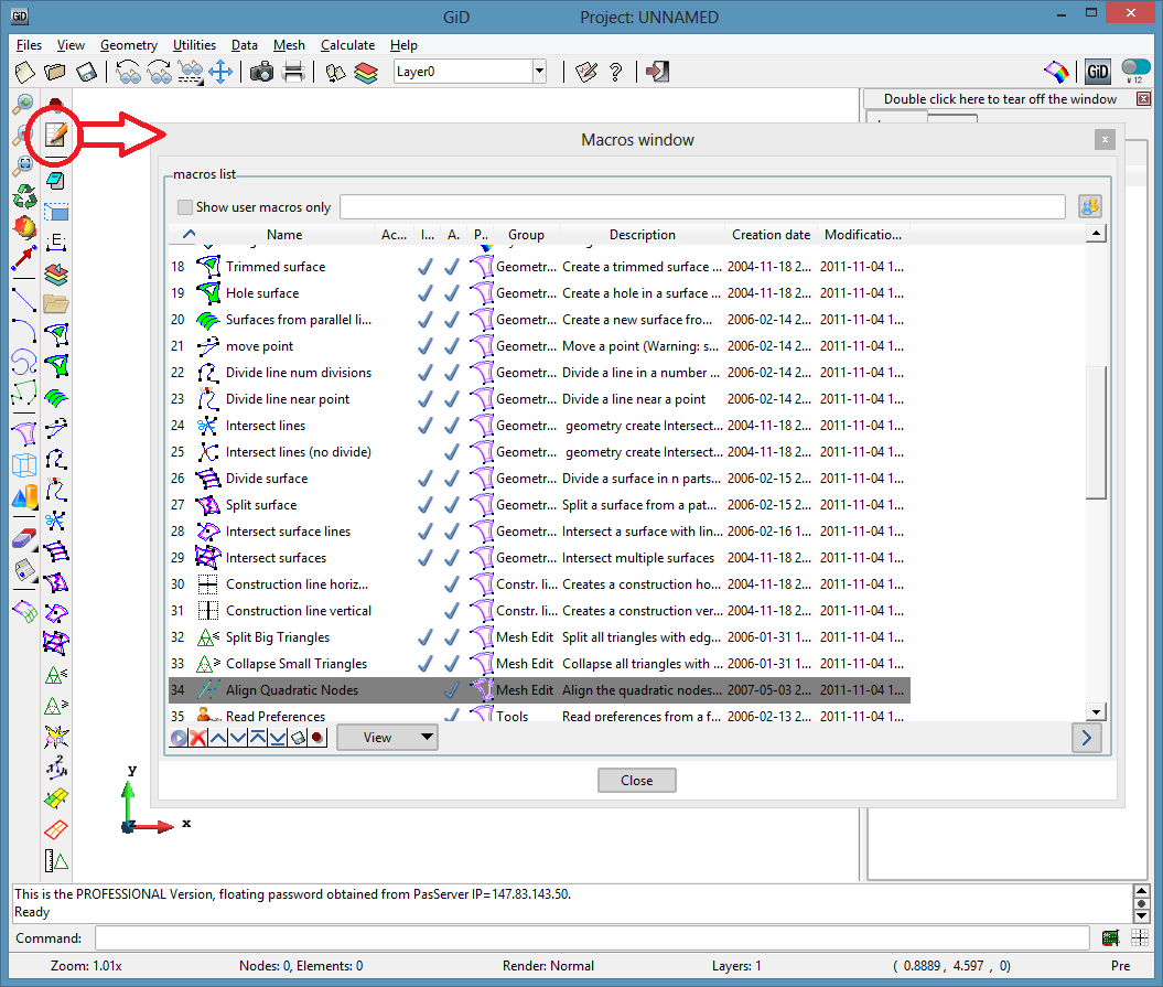

As you pointed there is a macro button that force all quadratic nodes to be at the mid-point of the corner vertices (but this macro is not visible by default in the macros toolbar)

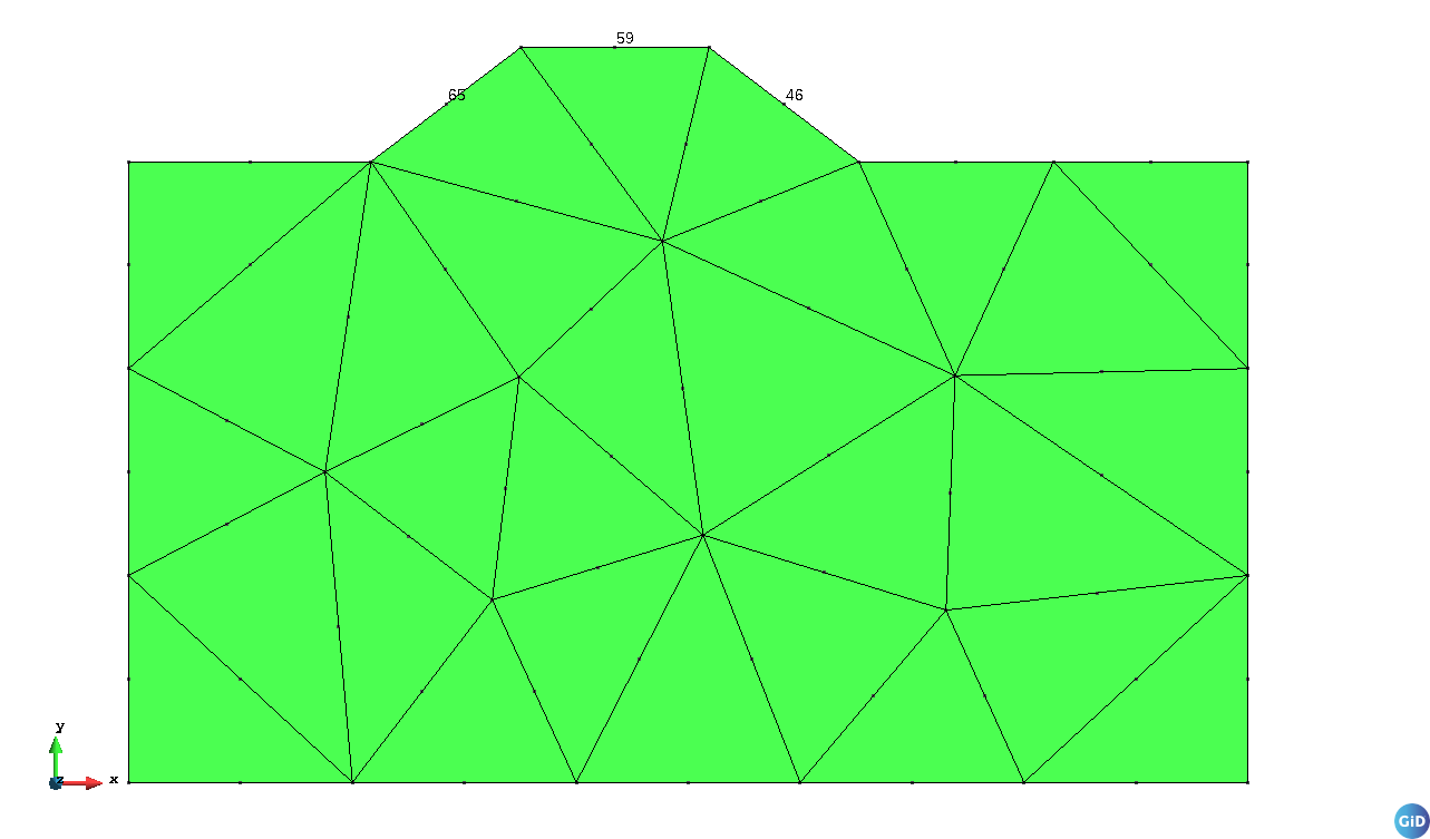

So, apart from the curved line, say I have a surface with a curved edge, would the element whose nodes doesn't lie on the curve can still have curved edges? I think the mesher says some elements might be distorted based on what mesher we choose.
Re: Quadratic mesh
If do you have a surface with with a curved edge, only the nodes lying on the curve will be projected to the curve (and could then provide a curved edge). The rest of the nodes of the surface will be projected on the surface. If the surface has planar shape, then it is expected that its edges become aligned.
if the surface is curved, e.g. half-sphere, then mid-nodes will become also curved

I know this is an old post, but after reading it's not clear to me why the 8-node quad elements don't have their midside nodes exactly in the middle between two vertices (I checked this in GiD 16 and it always gave the mid nodes not in the middle). Do we have to click on "Align the quadratic nodes to the mid edges" every time an 8-node quad mesh is generated? Why isn't this the default?
Re: Quadratic mesh
The mesh approximate better the original geometry if the nodes are projected on this geometry, not simply located as mid-edge coordinates, then this is off course the default.
Only in rare cases, where maybe the curved shape provide self-intersections or negative jacobians, seems interesting to be located in the mid-edge, then can simply use the tool you know.
