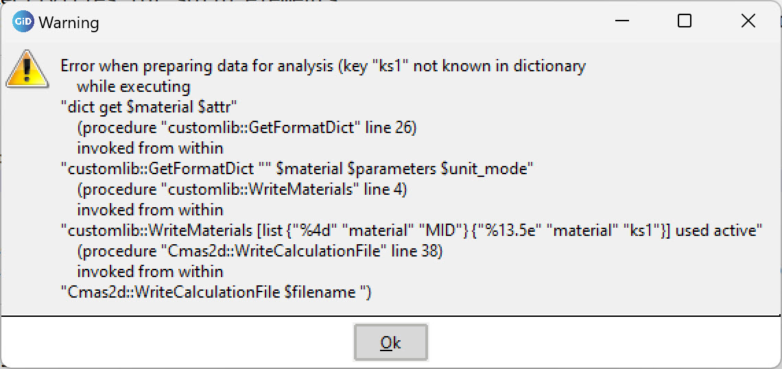

Starting from cmas2d_customlib.gid example, I’ve been trying to set up my own problemtype. Here, I revised the preprocess files to accomodate two editable material data sets. In GiD, I can access to and edit the two material data sets but I’m getting some error messages in GiD when moving to Calculate step.
Below is what I changed in the preprocess files.

Attached is a screenshot of the error message. It seems like when writing out the material properties in input file, it encounters an error…

Re: Using two editable material property dataset in cmas2d_customlib.gid example
Dear waseda
Sorry for the late response.
I've found a bug in the GID code thanks to your query. It will be fixed in the next GiD version
You can fix it in your installed gid so you can keep on working.
In the GiD installation folder, find the file scripts\customlib_extras\customlib_extras.tcl
Find the function customlib::InitMaterials
One of the lines in this function is:
Please, repace it with
I could not test it with real data since I don't have an example.
Please let me know if it worked for you.
Javi Gárate
set xp2 {.//container[@n="materials"]/blockdata[@n="material"]}
set xp2 {.//blockdata[@n="material"]}
Javi Gárate
GiD Team
Javi,
Thank you for your answering my question. I changed the code in scripts\customlib_extras\customlib_extras.tcl as you suggested. It worked ok after restarting GiD. Again, thanks for you help!!!
