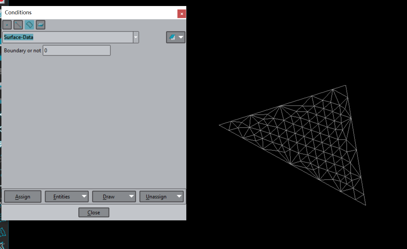

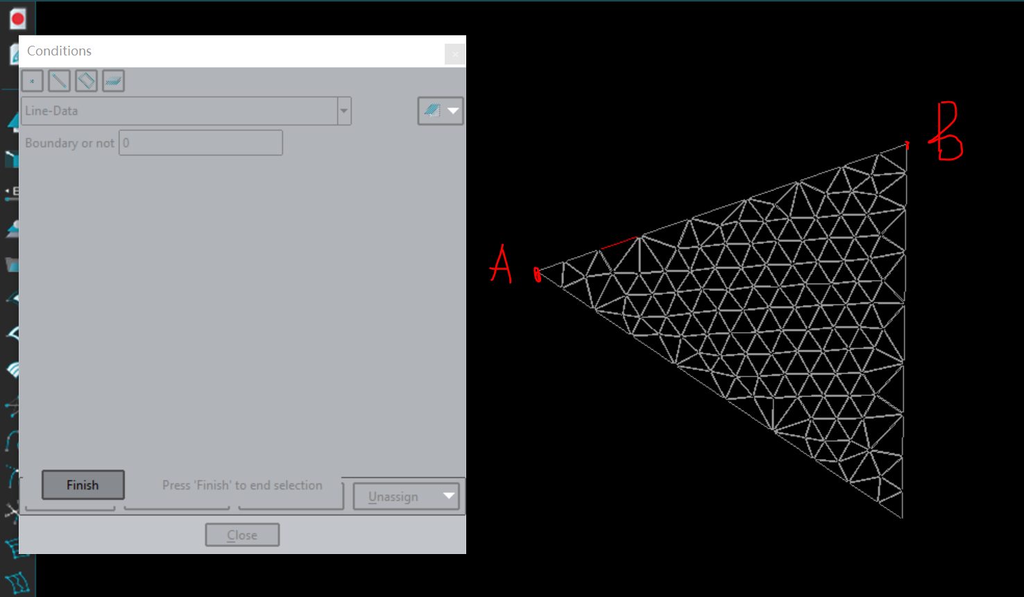

Hello! Thank you. Just like the figure, I want to set the condition by choose the line "AB", but it seems that only one element can be selected at once. In .cnd,
CONDITION: Line-Data
CONDTYPE: over lines
CONDMESHTYPE: over face elements
QUESTION: Boundary or not
VALUE: 0
END CONDITION
What's more. For two-dimensional models, is it not possible to set boundaries over elements?
In .bas,
*Set Cond Surface-Data *elems
/discrete-element boundary *nelem
*loop elems
*Cond(1)    *\
*end elems

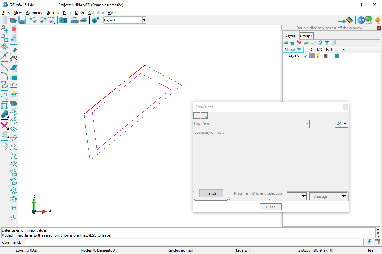

I repeat the same again, the normal way is to assign data to geometry, not to mesh!!
then generate the mesh. You can see drawing the condition by colors that the correct faces of the triangles are marked (note that they don't exists line elements, only triangle elements

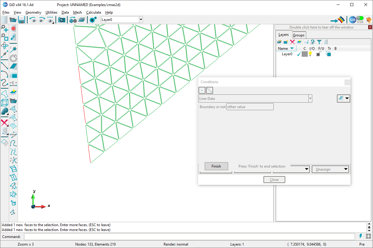

You can also directly assign to mesh faces, but is harder (but you can use all selection options)
