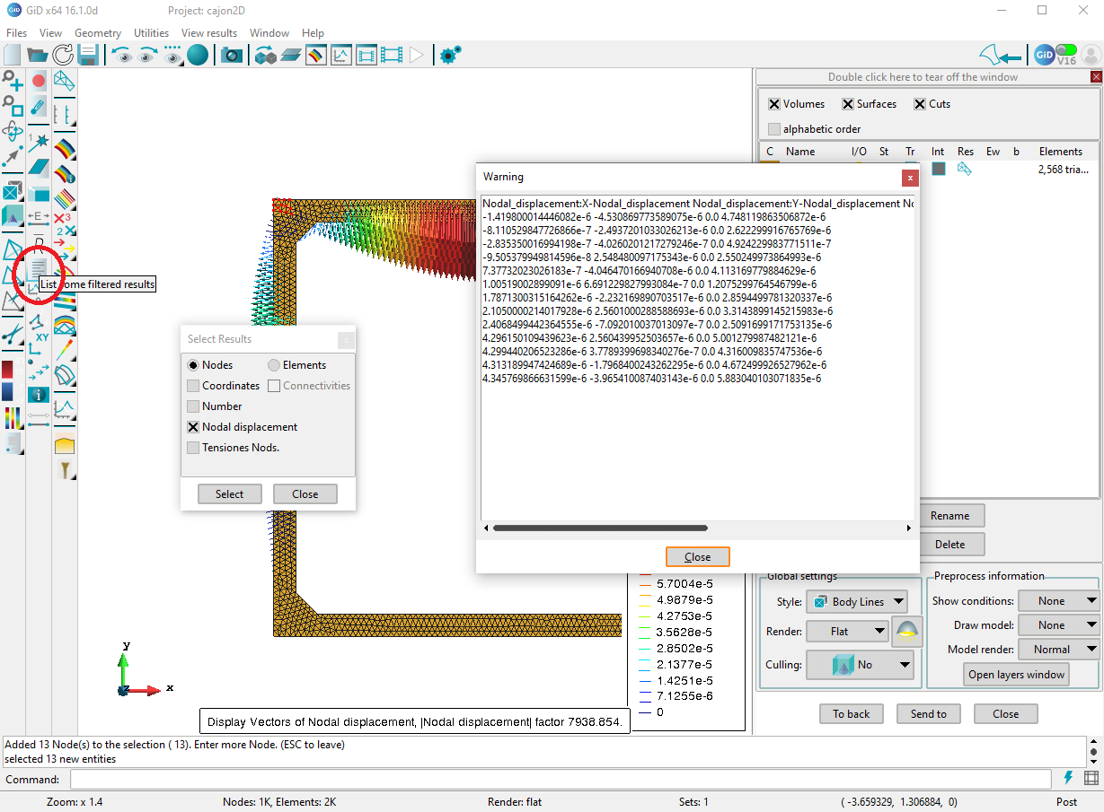

It doesn't exists this exact option, but for example it is possible to use the macro 'List some filtered results' from the macros toolbar, and select the kind of information of the available results that you want and select only the entities you want, and the results will be showed as simple text (that can be copied/pasted to be processed for example in Excel)
You can see the Tcl code of this macro, from the macros window, and create a similar one that do exactly what you want.
Maybe we can enhance a little this macro and print at the end some extra statistic information like the sum of each column, the average, ...
There is another more simple macro (the button just before the other macro) that show the averaged value of the current result, without allow selection, and also don't provide exactly the summatory, it is divided by the amount of entities
