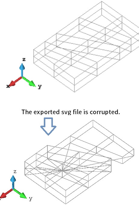

It seems that "Print to file" "SVG.." in mesh drawing corrupted.
Print to file SVG in mesh drawing corrupted
- test3d_mesh.jpg (74.17 KiB) Viewed 24590 times

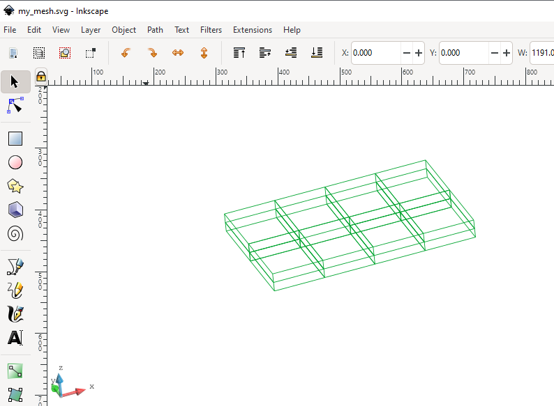

Please, attach a zip with the GiD model.
I have tried with a similar model, it is attached and it worked well
This is a screen capture opened with the InkScape editor
- gid_export_svg.png (48.56 KiB) Viewed 24582 times

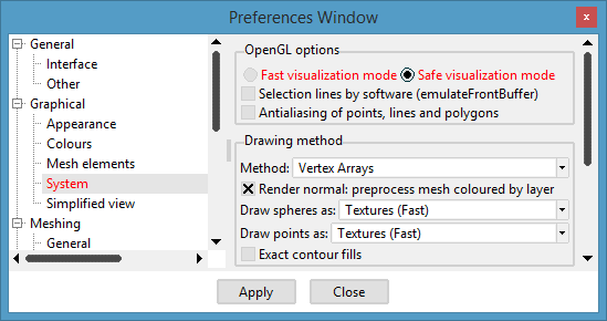

Hi Hemmi,
Are you using an AMD Radeon graphics card? Which graphics card are you using?
We found a similar problem with the drivers of AMD Radeon cards and are solving it.
Can you try the Preferences --> Graphical --> System --> 'Safe visualization mode' ?
and see if the SVG is exported correctly? Can you send us your gid.ini file (located at c:\users\<YourUserName>\AppData\Roaming\GiD\15.0.3\gid.ini) ?

Re: Print to file SVG in mesh drawing corrupted
Thank you for the answer.
The graphics card of my laptop PC (Lenovo ideapad 330S-14IKB) is
Intel(R) UHD Graphics 620.
After changing to "Safe visualization mode", the correct figure is drawn; thus the problem solved.
The attached gid.ini file is the version after "Safe visualization mode" applied.
