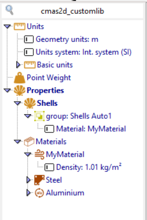

  • The resulting data tree is the following:
    Data tree after applying 'Shells' condition

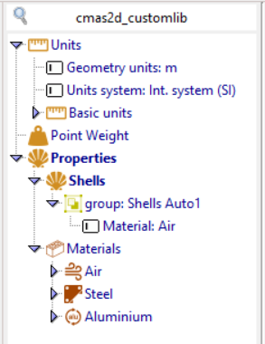

  • But, if you change the name of the material after that, the 'Shells' condition does not automatically update:
    Data tree after changing the material name
