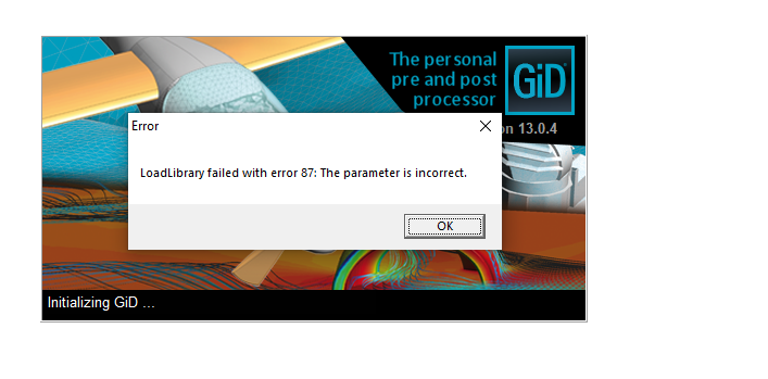

Hi there,
I am getting the error attached when I am starting the GiD software. Kindly, could you advise on this?
Kind regards
Bashar
error when launching the GID software
- gid-problem.PNG (151.09 KiB) Viewed 8550 times

Which operating system? Windows, Linux? x32 or x64?
The error message don't said what is the library that is trying to load when the error is raised, then is difficult to know what is the problem.
Has ever started this exact GiD 13.0.4 version on this computer?
If yes then try to reset all user preferences. (http://www.gidhome.com/documents/faqgid ... references)
Try also other GiD version, like the developer 13.1.11d http://www.gidhome.com/download/developer-versions
or current 14.x

Thank you so much for your reply. Reset the user preference works. Thank you so much.
