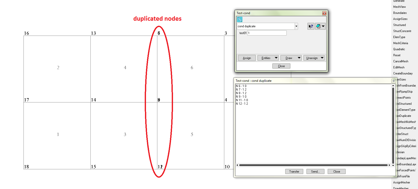

I place a condition on a line with CONDMESHTYPE= over nodes.
After I use the command “Mesh/Mesh criteria/Duplicate/Line” to duplicate the line.
I mesh the structure.
The line is meshed and all the nodes of this line are doubled. I have twin nodes for all the nodes of this line.
When I list this condition (entities mycondition), I have a list of all the nodes with this condition but I have only 1 of the twin node. Before with GiD13, I had the condition on both the twin nodes.

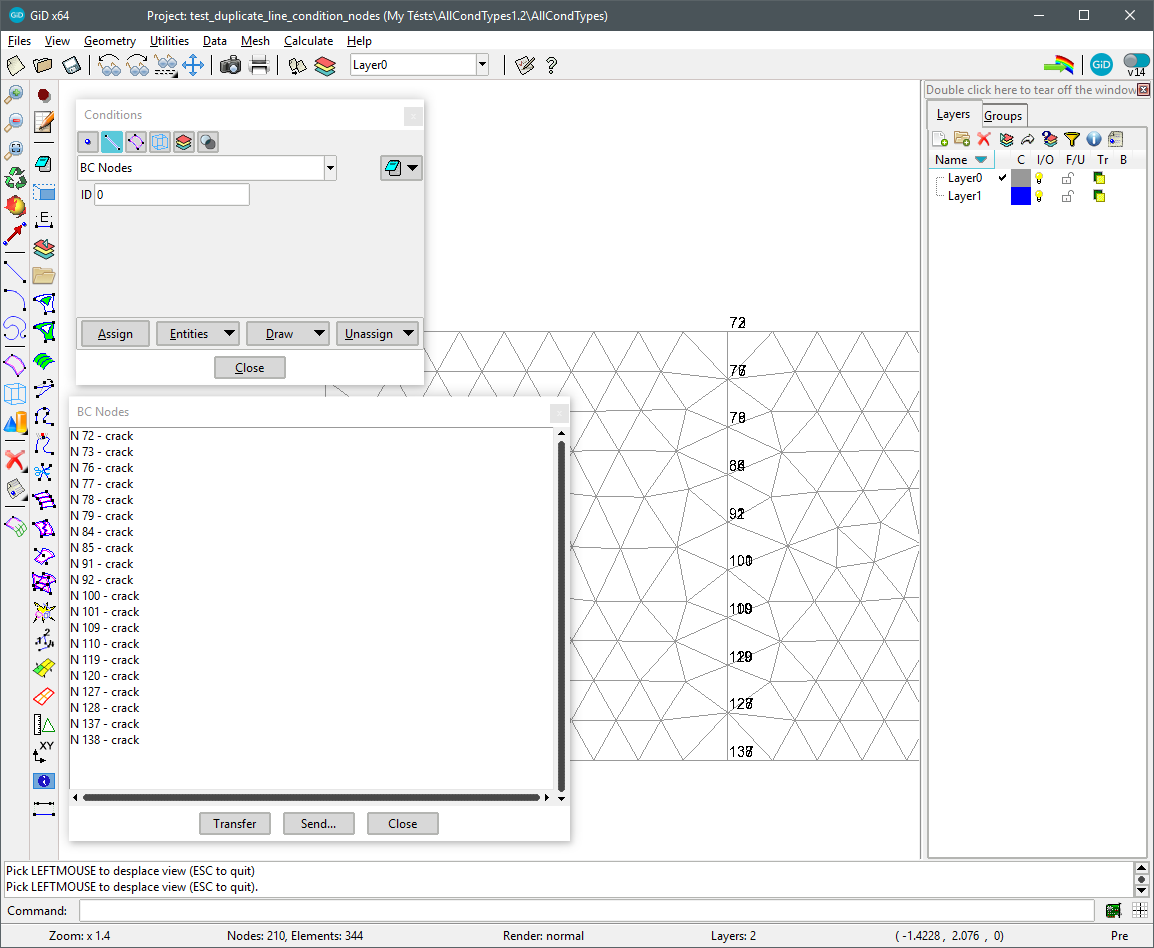

Are you sure that the condition is not really applied to both twin nodes?
Maybe they are applied to both but they are finally written in your calculation file only in one?
Use the 'Entities' button of the conditions window to see the list of nodes with the condition and its values.
e.g.
I attach a simple example, a rectangle divided in two surfaces, sharing a line.
I have set this line 'to be duplicated when meshing' (Mesh->Mesh criteria->Duplicate->Lines)
and I have assigned to the line a condition (of a testing simple problemtye), named BC_Nodes, over lines->over nodes
Then when generating the mesh the nodes are duplicated (you can see visually with: View->Higherentities->Edges)
and In the condition window if I list ('Entities' button) I can see that there are 20 nodes with the condition (10+10 twin nodes)
This is my model, you can try it:
test_duplicate_line_condition_nodes.zip
(30.54 KiB) Downloaded 581 times
What is your exact GiD 14 version and OS?
If continue failing, please, attach a zip with a small model to test it
